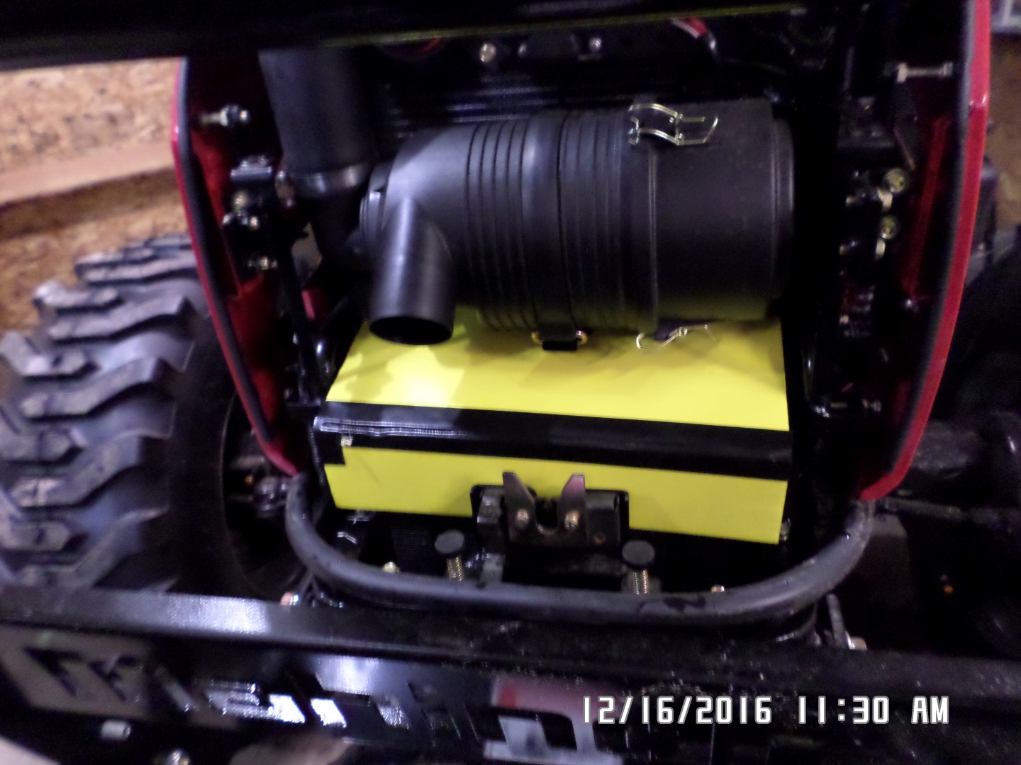

Thanks for the quick reply. I was actually quite surprised to read that diesel powertrains work with the OBDII standard. I have a diesel-pusher motor coach, and it uses a round (9-pin?) diagnostic port that won't work interface with the OBDII standard plug. ScanGauge actually makes a diesel version of their hardware for those rigs. So I never gave it any thought to attach my bluetooth scanner to the tractor until I came across this thread.
I've made a cursory scan of cables inside the cab of the 2555, but didn't find anything. A search on YouTube shows one guy (in an open Mahindra tractor) pulling the port from a bundle that is more under the hood than at the operator area.
I'll give it another look with daylight. Thanks again...
Open up the hood. OBDII port is dead center above the battery/air cleaner facing forward. Has a black cover on it and is a little hard to see if the hood is blocking your barn lights, and if you have 'old eyes'....... [ sniff, sniff-sniff ] :) [ in the below picture it is at the very top center... ]

That is priceless info. Thank you! Unfortunately the daylight disappeared before I returned home today. And, my barn isn't built yet (though materials are all here). This time next week I won't have that excuse! I'll post back tomorrow, if the process isn't overcome by other events.
   / OBD Code Reader #33
@jerryk - that was it! Right where you said it'd be. Now I have to find my BT OBDII thingy I bought over a year ago...
