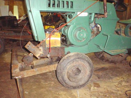

Sunday project. Needed to move some cleachie to leval yard. Used 10" I beam, halve truck springs, 3/4"and 5/16" rod, some pipe and plate.

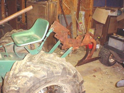

A side view showing manual linkage.
   / Odd Parts Machine
#24
Here's a shot of a David Bradly turning plow reworked to 3ph. I have been using this several years to break up the cleachie for leaveling and trenches.

It worked well, moved about 3yds before 2 welds broke loose from the springs. Forgot springs are tempered and brittle. Oh, well time for 3/8 plate.

Cleatus on your blad on the I beam in the bottom cornerof the blade to make spreading and grading easier try mounding a peic of 1/4 to 3/ths by 2 flat bar on an ange from the bottom of the flange on you Ibeam blade. to the web. It will help peel and roll the material like a big dozer. I had a smalljob onecewhere the busness owner had a small walkway /alley between 2 stores. They had a commonroof theouh. To lay down the stoen Id haul it in from the street in a homemade dump cart behind a garden tractor down a the 36 inchwide alley then I made a blade similar to yours but i made my blade with a cutting edge like I described. Took all day but faster and cooler than the alternative.

Taylor I had been thinking the same thing. Also in the above explanation of cleachie, I ment to say it's what gravel roads are made of.
