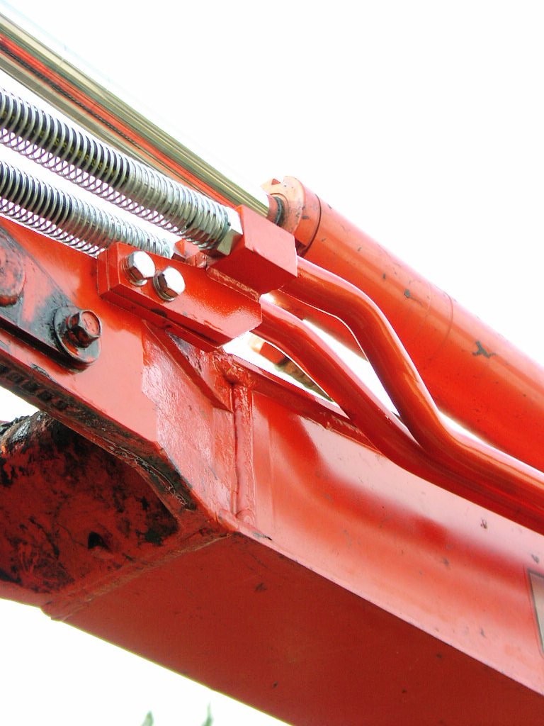

Anyone hear of a 13/16 x 14 O-ring fitting? It connects a hydraulic hose to hard pipe on my mini-ex.
I'm in the last stages of installing a thumb on it, but am having a heck of a time finding some sort of adapter to go from the o-ring female end of the pipe to AN-6 hose. This fitting is what Kubota used, obviously for a different size hose. I'm about ready to cut the pipe and weld on a standard size end.

Its .811 inches / 20.43mm in diameter across the threads with a 1.75 mm pitch, I too thought it was metric, but I could not find a reference anywhere for that specific size. It very well may be a special metric size. But it seems to be closer to 1/2 British.

what brand of mini ex do you have? The Japanese had some weird sizes and styles for awhile that where similar to to BSPP.
Roy
/ Odd size fitting #7
JIS
Japanese Industrial Standard: This coupling looks similar to our MJ and FJX fittings. There are two major differences - the threads are BSP and the seat angle is only 30-degrees instead of 37-degrees.

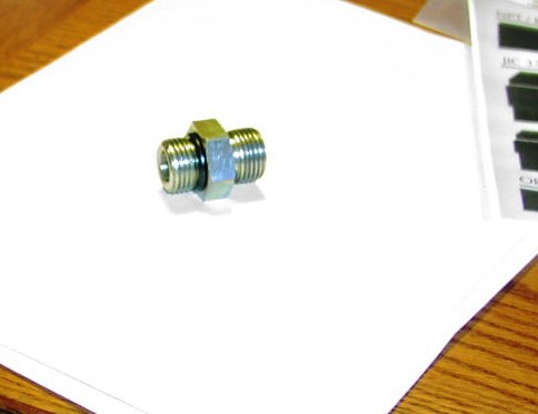

It looks like a 1/2" BSPP (British Standard Pipe Parallel) to me.
According to my charts, that will be a 13/16-14 thread.
The only thing that looks odd in your picture is the O-Ring. Usually, BSPP fittings have either a bonded seal (metal washer with rubber seal) or a captive O-Ring held in place with a metal washer.
Could be the captive washer is gone from your fitting, but otherwise, going from the dimensions and photo you supplied this looks exactly like 1/2" BSPP.

I did not pick BSPP because the major diameter he stated was .811", and a 1/2" BSPP should be .8250", and 13/16" is .8125 in decimal.

I have the "what size is your thread?" conversation almost daily with customers who are having trouble identifying their fittings. In my experience, a variation of 10 or 15 thousandths of an inch is completely negligible and even to be expected. Depending on the precision of the measuring method (or the individual taking the measurements), even larger discrepancies are not uncommon.

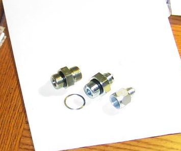

Anyway, a solution arrived today from McMaster, 13/16 -14 (1/2) BSSP as thought and JIC 8, 3/4-16 on the other. I already had the 8 to 6 JIC adapter. I also noticed that a recess is machined into the pipe on the excavator, hence no washer.
I ordered some adapters from Dis Hyd Hose to go directly from the 1/2 BSPP to JIC 6 - they should be here tomorrow. I'd rather use those as there is one less connection point.
Thanks for the help everyone. Hopefully, I can put the machine to good use over the weekend.

To bring closure, everything fit.
