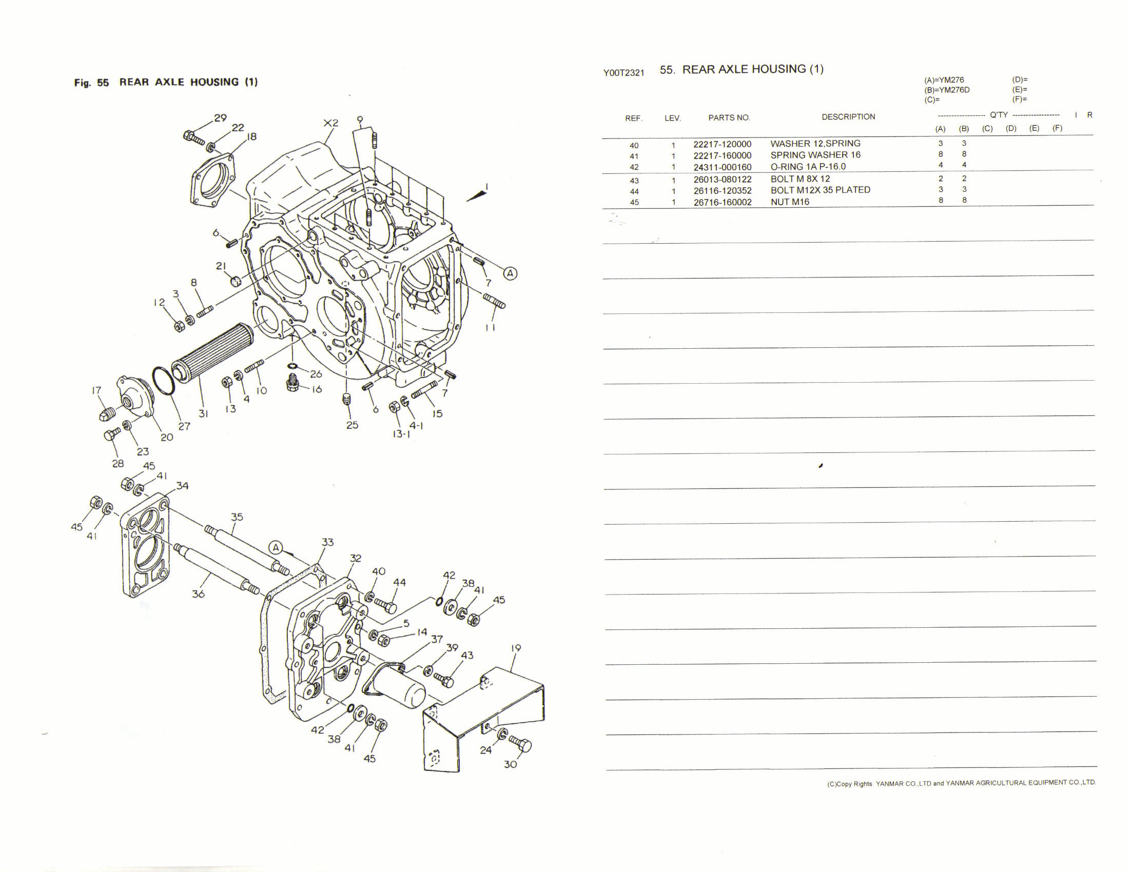

Right here.

Thank you Winston1, I appreciate the help. Is 31 the screen? Is this screen usually cleaned rather than changed? I will try and look at it tomorrow. Thanks again!

I'm glad to hear it's cleanable! I bought the Filter, it came up as a Baldwin B2 at my local Tractor store. I'll have to take a peek and see if the screen is accessed easily. If not I may wait for my help to return. Thanks again!

just an FYI.. Before you pull that cover to access that filter screen. Drain your HYD oil
If you remove that cover with HYD oil in the tractor, You'll be covered in oil, as it will all come out at once when you pull that cover
