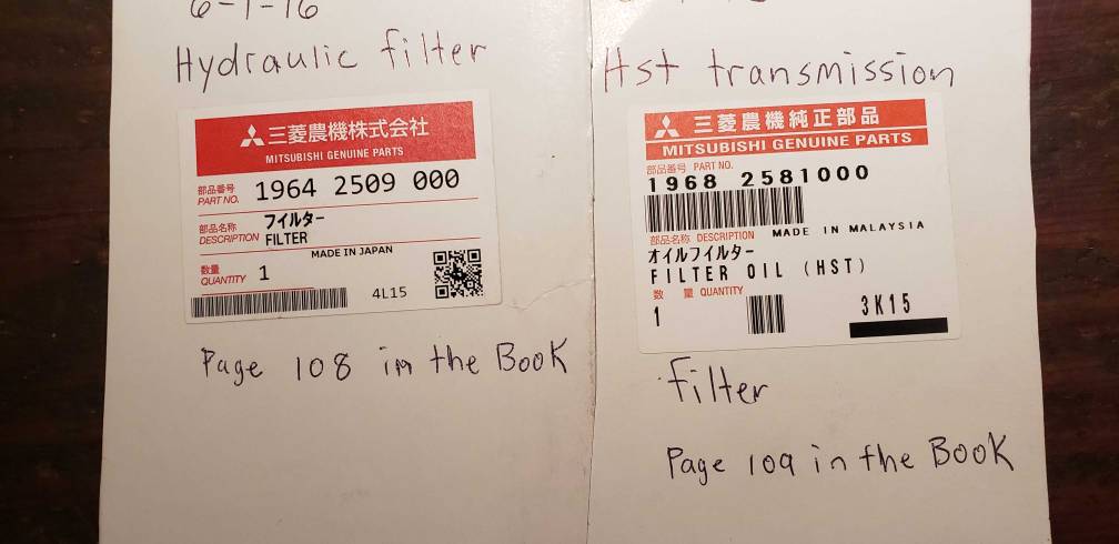

I have a Mahindra 1526. Which I think is about the same. Mines just newer. My filters are solid black also. The hydraulic filter part number is 19642509000. The part number for the HST transmission Is 19682581000. The boxes are solid white with a white and red them. That say Mitsubishi genuine parts on them. 1580497231632.jpeg

I have a Mahindra 1526. Which I think is about the same. Mines just newer. My filters are solid black also. The hydraulic filter part number is 19642509000. The part number for the HST transmission Is 19682581000. The boxes are solid white with a white and red them. That say Mitsubishi genuine parts on them.View attachment 639487
Same filter as mine. Thanks for the pic. I guess I have nothing to worry about:thumbsup:
   / OEM Mahindra hydraulic Filter? How do I know that this filter is genuine? #8
Those are the OEM filters in the photo.
