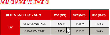

Another reason to NOT mix batteries, I might have mentioned this but it is good to repeat, is that different batteries, even of the same type and AH, can require different charging voltage. One needs to check the battery manual for proper charging voltage at a given temperature THEN see what the voltage is being used by the battery charger.
Look at the charger manual page that RNeumann posted compared to this charge voltage table segment from the Rolls AGM battery manual:
The battery requires 14.70V and 13.80V for charge and float voltage at 77 Degrees. The charger is using 14.2V and 13.2V at 80 degrees which is a pretty big difference. Partial State of Charge(PSOC) is a big killer of batteries.
One needs to match the battery's charge needs to the charger and some chargers are not adequate for the battery. Some chargers can be programmed though.
This battery OEM's website has quite a bit of battery information. Solutions : Technical Support Desk
