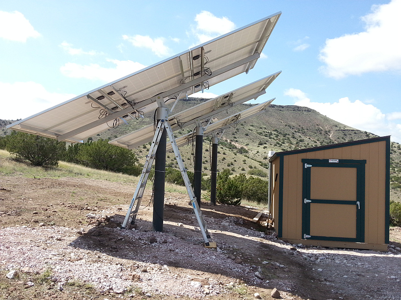

FWIW, we finished our retirement home early this year and have been living in it full time since April. Only solar for electric as the nearest power lines are many miles away.
We have 27 255W panels on three poles connected to dual Midnite Solar Magnum inverters and Classic charge controllers. 16 Surrette AGM 830 aH batteries wired as two 48V banks in parallel for 39.8 KWh of storage.
The panels are nearly 100' from the house so we put a small TuffShed building right next to the panels to hold the batteries and inverters. That way we could run straight AC to the main house panel in a trench.

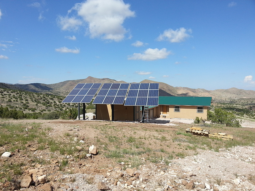

The house is stick-built on a pier and beam foundation. The walls and floor have R23 denim insulation. The roof has R30 blown in fiberglass. For heat we have a normal gas furnace running off propane and also a Harmon P68 pellet stove fairly central in the main living space (kitchen, dining area, living room and sitting room) which is an open plan. Other than testing the furnace so far we have only used the pellet stove. Stove and dryer are propane Kenmore units. Water heater is a Rheem on-demand also on propane. Dishwasher, microwave and fridge are also Kenmore units. Generally speaking we went with efficient appliances but didn't go overboard on it. We added a small Whirlpool 14 cu ft chest freezer in the garage this summer. Cooling is with a MasterCool ASA7112 evaporative cooler (1hp). The house is 2300 sq ft.
So far we've been using between 300 and 450 kwh a month with plenty of available power. This winter will be the next big stress test on it with the colder temps and shorter days but not foreseeing any issues as the solar system was actually up and running before last winter.
After federal rebates the complete system including the shed and having the big poles put into the solid rock of the hillside was about $28k. A power line to here would have been many millions of dollars.
Note this is in central New Mexico at an elevation of 5600 feet. We get more than 300 days of sun a year. YMMV.
So, Eddie, now you kind of know 1 person that put in solar and doesn't regret it. :) If you make it over to the Socorro, NM area some time let me know and we'll show you the system.
