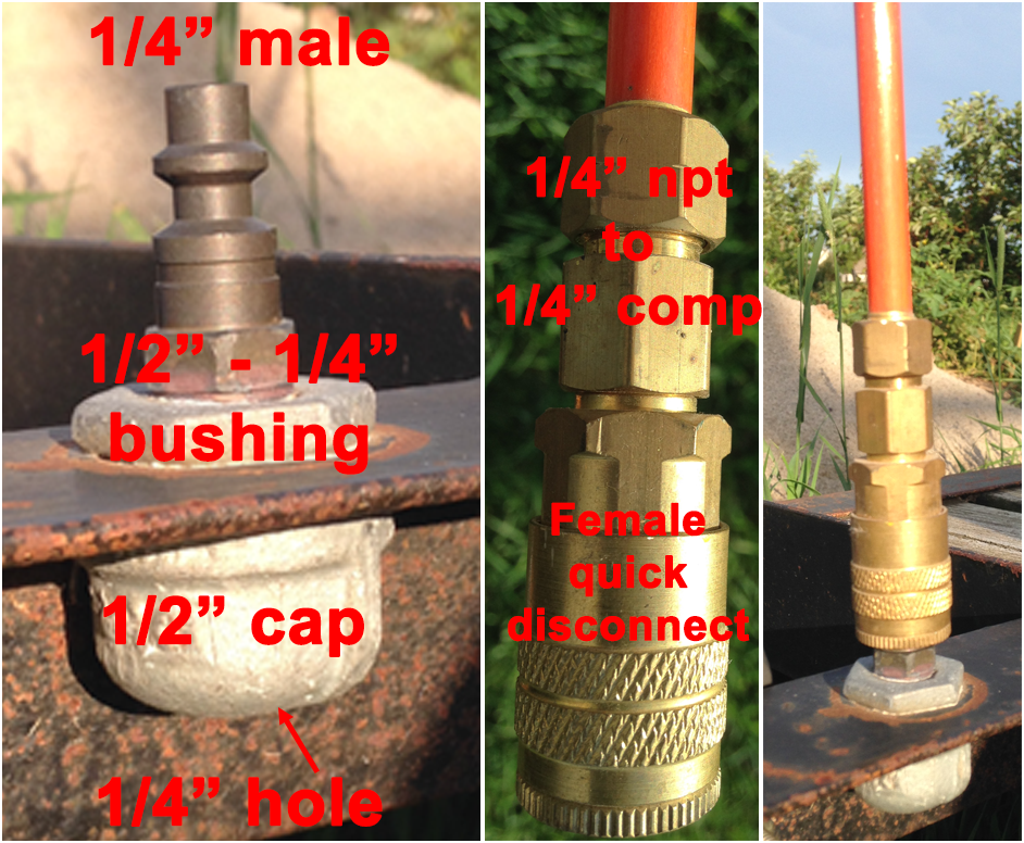

Wow! Now this is a nifty little trick!
   / Off-road flag #13
If not a big problem, a picture would be helpful.
No problem...here it is, hope it helps.
   / Off-road flag #14
Thank you.
