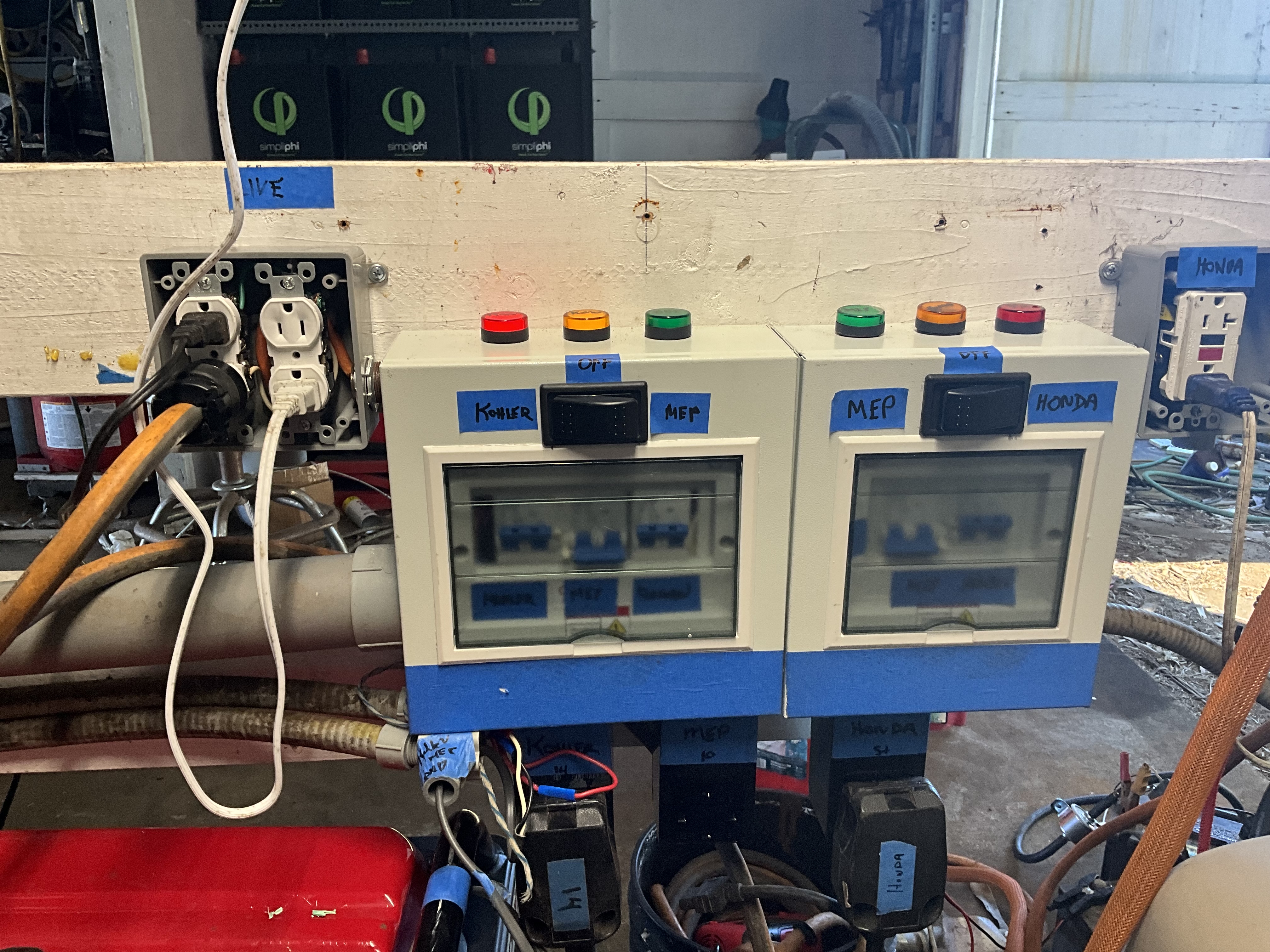

This is my old FX inverters controlling the Honda generator
/ Offgrid Genset Transfer switch
#23
When finished, either system will be able to control MEP diesel generator via selection from switch at top. Of course appropriate breakers engaged, disengaged.
MEP needs batteries so not usable yet.
All generators are autostart
Other than gen selection and breakers, operation can be controlled via internet.
As for the receptacles
Left side are live, powered by inverter and provide power to my trickle chargers and overhead light.
Right side is powered by Honda generator and provides power for the exhaust fan to run when gen runs.
Soooo, almost done, but at least functional.
#25
Hardware availability can be mixed. For this project I bought everything online. My solar systems have been a mix, most locally sourced, but many of my replacement PV came from mainland. My Kohler genset was an online purchase but the Honda EU7000 was local. Yes, most of the neighborhood is offgrid as are many of my rural friends. Haven’t kept up with permitting and changing requirements. My initial system was fully permitted and a PITA, not bothered with my upgrades.
Sounds like you have grid tied solar, no batteries. Maybe adding a generator to the system will give you the capability to harvest solar when grid is out. The newer systems have capabilities I’m not familiar with.
