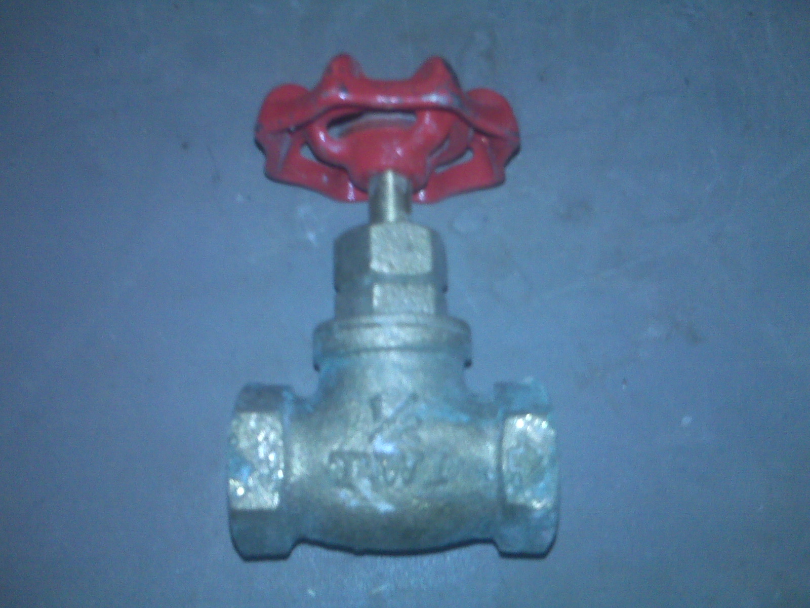

OK, problem - Maybe you guys can help ?
The hot water tap in our kitchen won't turn off.
It was dripping for a while, then 10 minutes ago my mother turned it on and it wouldn't go off.
It stops turning and you can feel it tightening, but the water keeps pouring out.
I've had to turn it off at the stopcock, but what is the problem with the tap ?

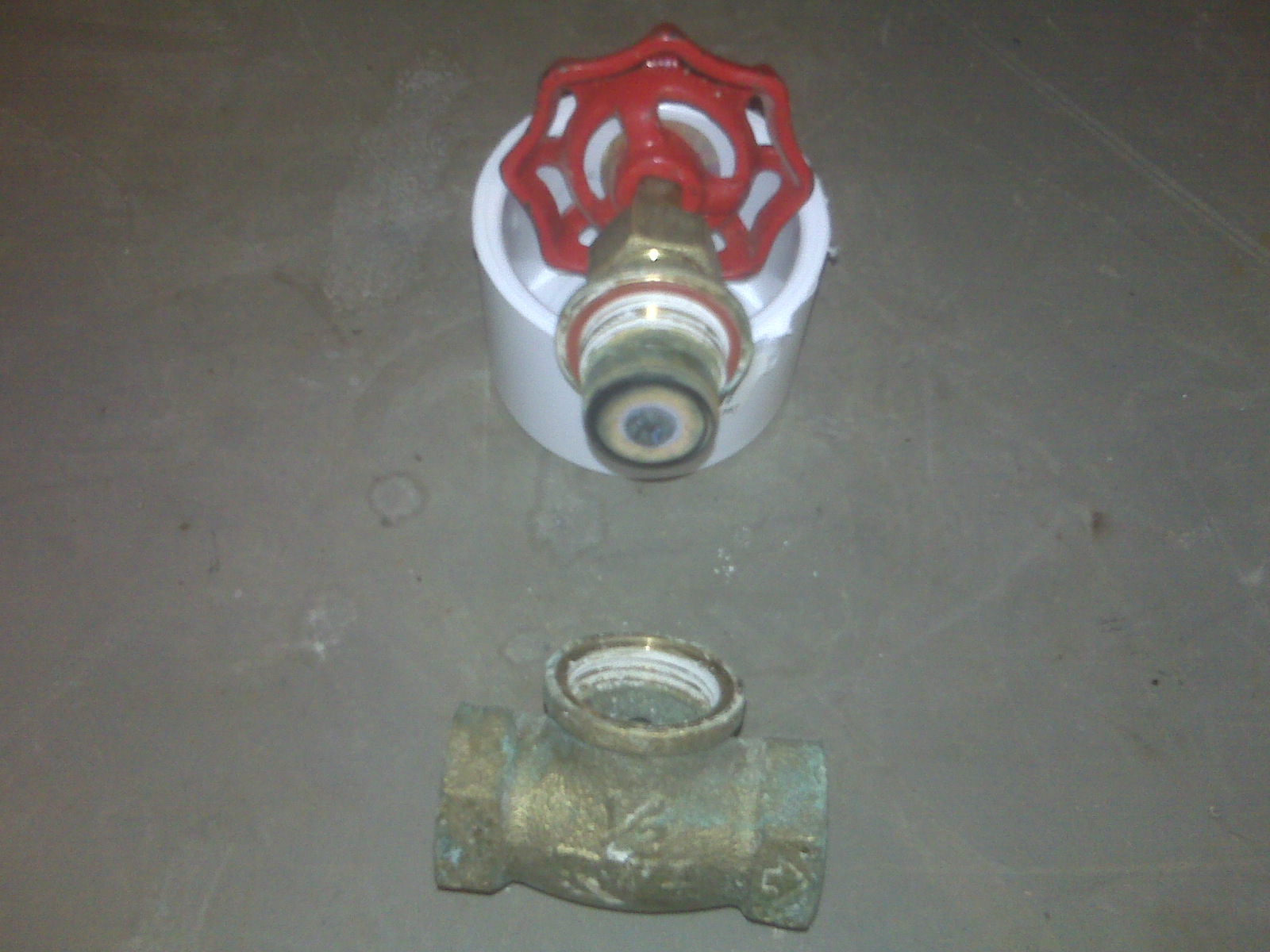

The valve seat on the handle is worn out...I assume it's the old type of faucet that you turn by hand...there is a rubber seat at the bottom of the hand wheel that is replacable, just remove the handle part and then unscrew the valve seat and replace it. I don't have a faucet here but my pics show a stop valve and then the top unscrewed and the rubber seat at the bottom.

Just to update you guys - It was a bad washer, so I replaced it and the tap is back to working again. Phew!
