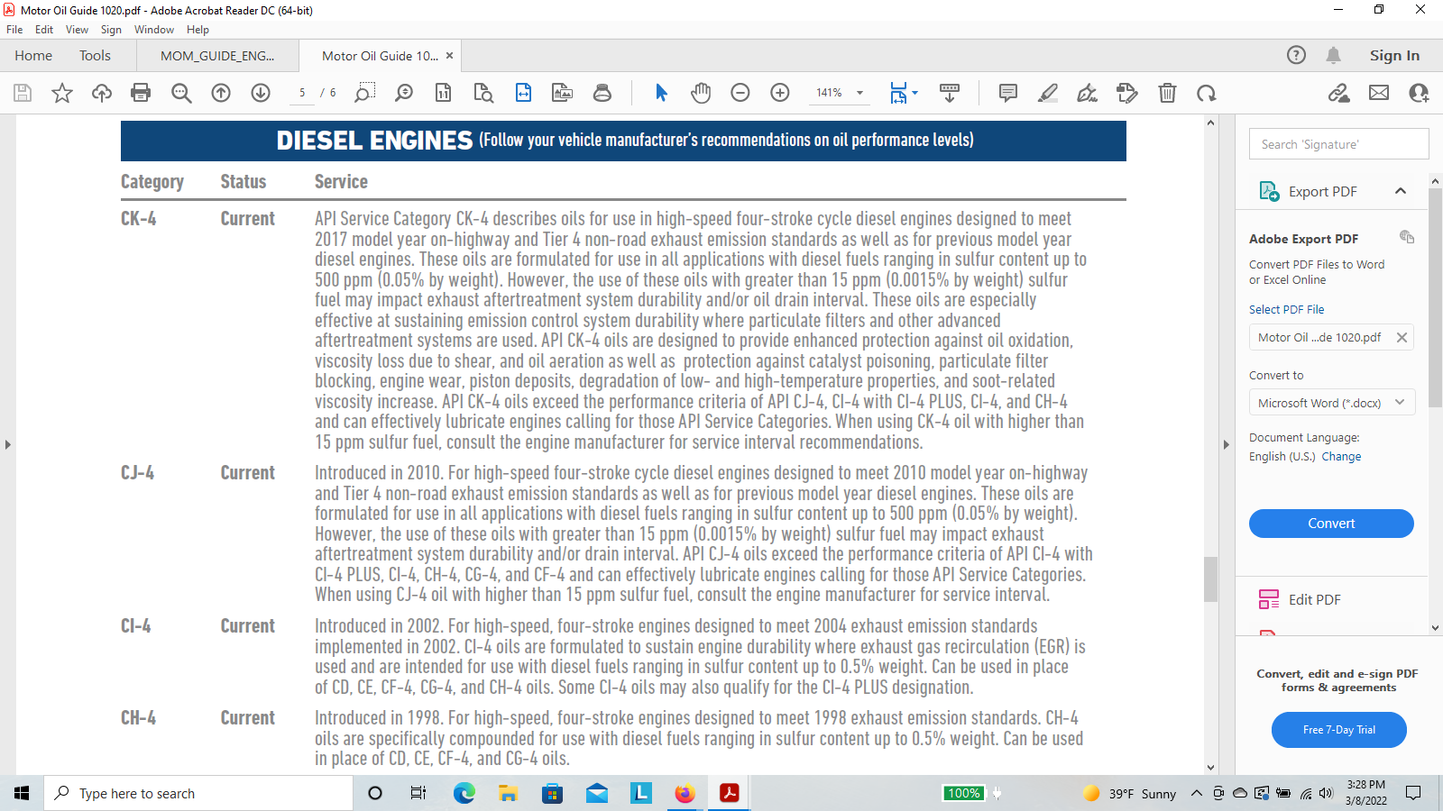

API CC and CD are obsolete, what "new" API code do I need to look for to meet the old CC and CD? It appears CI-4, CH-4, and CK-4 would all possibly be sufficient?

Seeing as I had this up for another post here we go again;
As has been mentioned CH-4,CI-4, CJ-4 or even CK-4 should work for you.
My preference would be an older formulation actually such as the CH-4 or CI-4.
