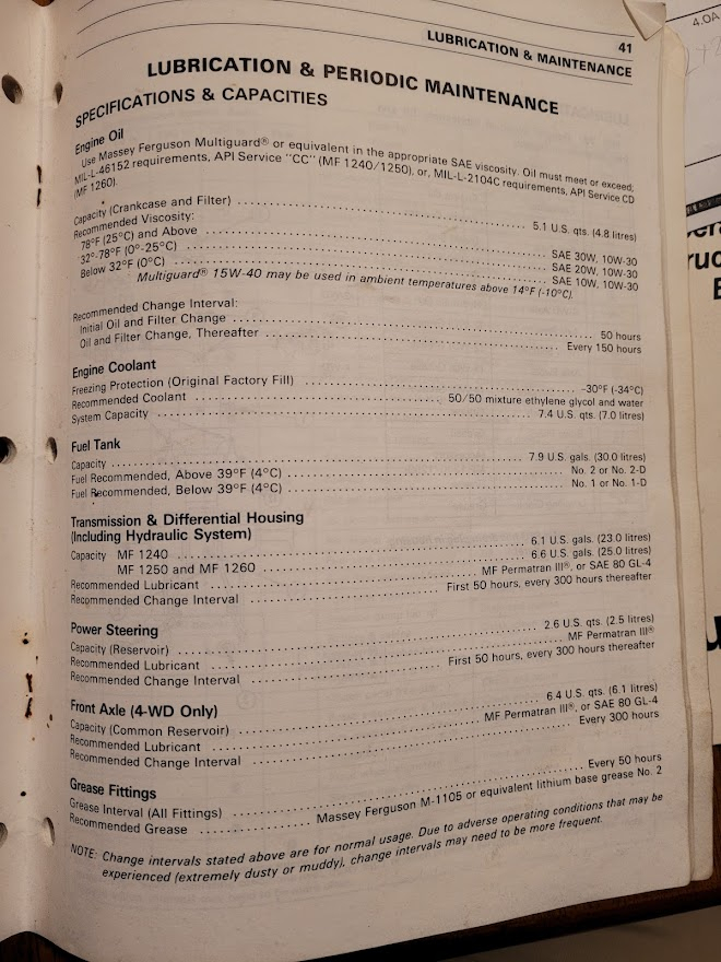

Manual says use Massey Ferguson Multiguard Oil or equivalent that meets or exceeds MIL-L-46152 API Service CC or MIL-L-2104C API Service CD
Maybe Mobil Delvac Extreme 10W-30 Synthetic Blend Heavy Duty Diesel Engine Oil? Or maybe I could just use the Quaker State SAE10w-30 full synthetic?
Any suggestions?
