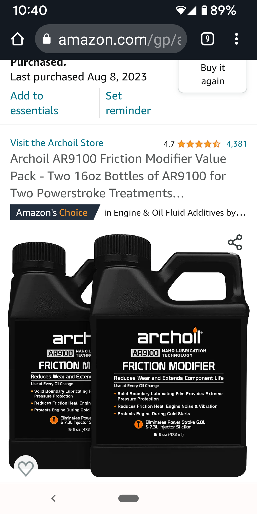

Someone just asked me about Nano-Borate and I don’t know anything about it.
Is there a link for the product you use?
   / oil decision #30
I know he is this because he posted on here a while back. I ordered some.
