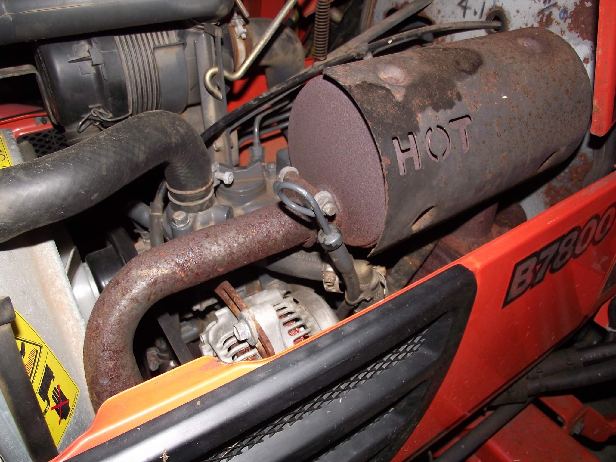

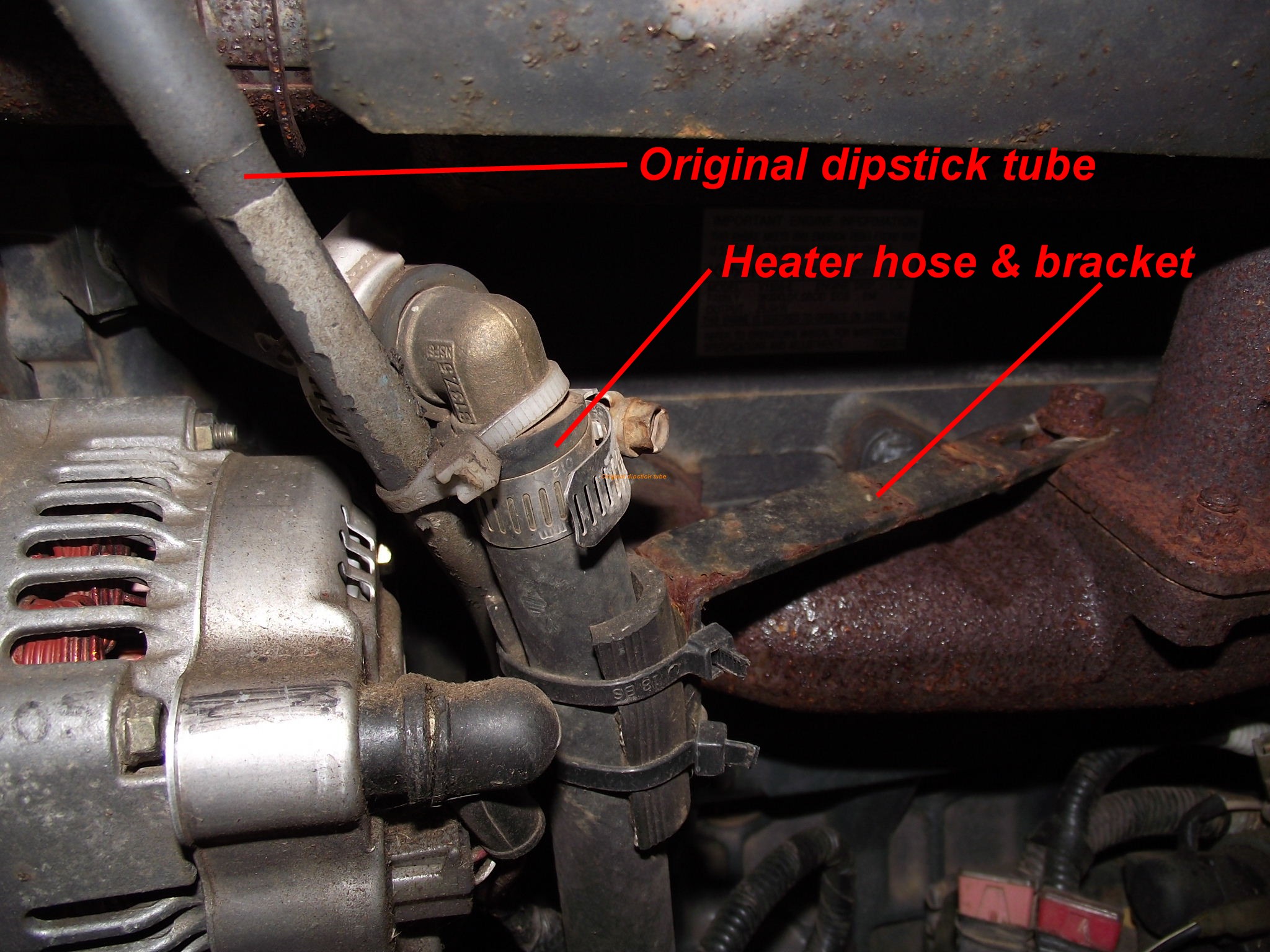

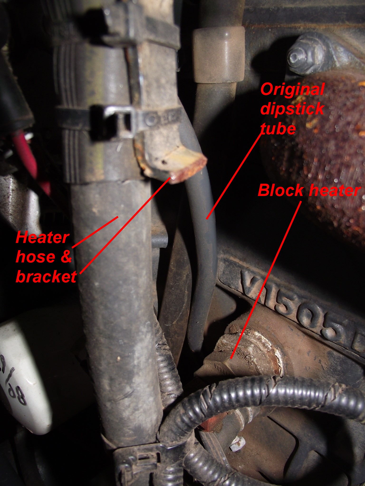

I installed the alternator kit on my B7800 after one winter with my heated cab. (The dynamo just could not keep up with the heater fan and the work lights.)
I didn't like the dinky dipstick that came with the alternator kit (had to remove the side panel to check the engine oil.) A TBN'er advised that you can tweak the bends in the original dipstick tube to fit around the alternator. It's a tight fit in my case beacuse my cab heater hose is also in there, but I was able to make it work. I cable-tied the dipstick tube to the heater hose where it is supported by a bracket I fabricated. See the attached photos.
The dipstick isn't as smooth re-inserting in the tweaked tube, but I find it much better than having to remove the side panel. Hope this helps
