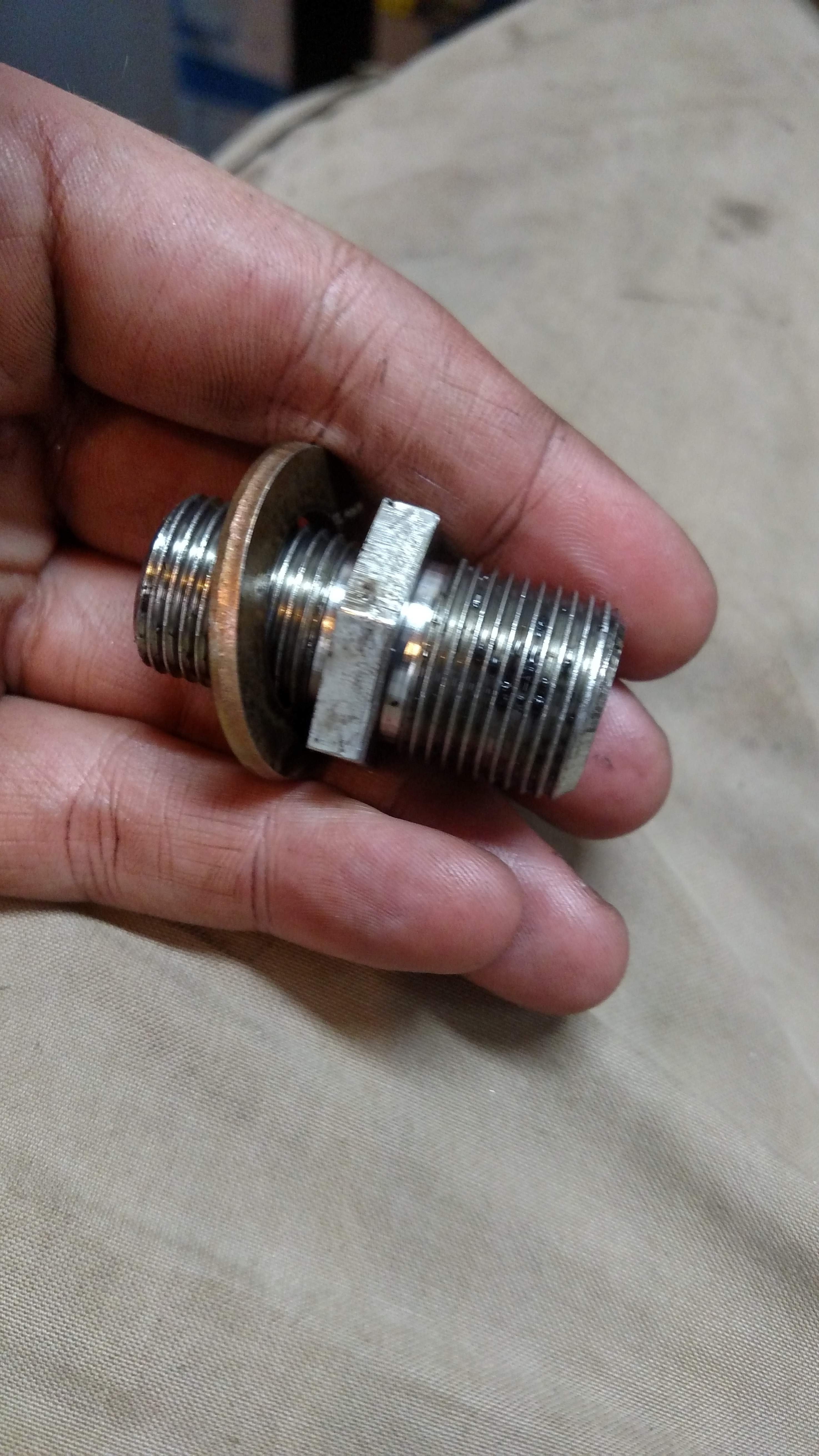

So i bought a used CT235. Oil looks nasty, so i went and got oil and a filter. Drained the oil, pulled the filter, and the new one doesn't fit. The new one is the Napa 1324. The old one is a Bobcat filter, but i can't find a valid part number on it.
The threaded hole in the new one is bigger than the old one. I brought it to a parts store, and the wix they have is identical to the Napa. What do i do?
My next step is to try a Bobcat dealer to see if they can figure out what the old one is, but no one will be open until Monday. Any ideas?

Kioti dealers are a bit far. The one that came off the tractor uses 18x1.5 threads, nearest i can tell. The NAPA and Wix ones are 20x1.5

The WIX 51324 is identical to the Napa filter i have. The NAPA guy says Wix makes the Napa filters too. The parts store guy pulled the 51324 and we measured. Identical. 1324 = 51324

I know. Thank you for the help. This is frustrating. I want to run the thing, but can't.... );
Hopefully this photo shows up
That's the part the filter screws into. I'm wondering if someone swapped that out at some point. Any idea if these are locally available?
