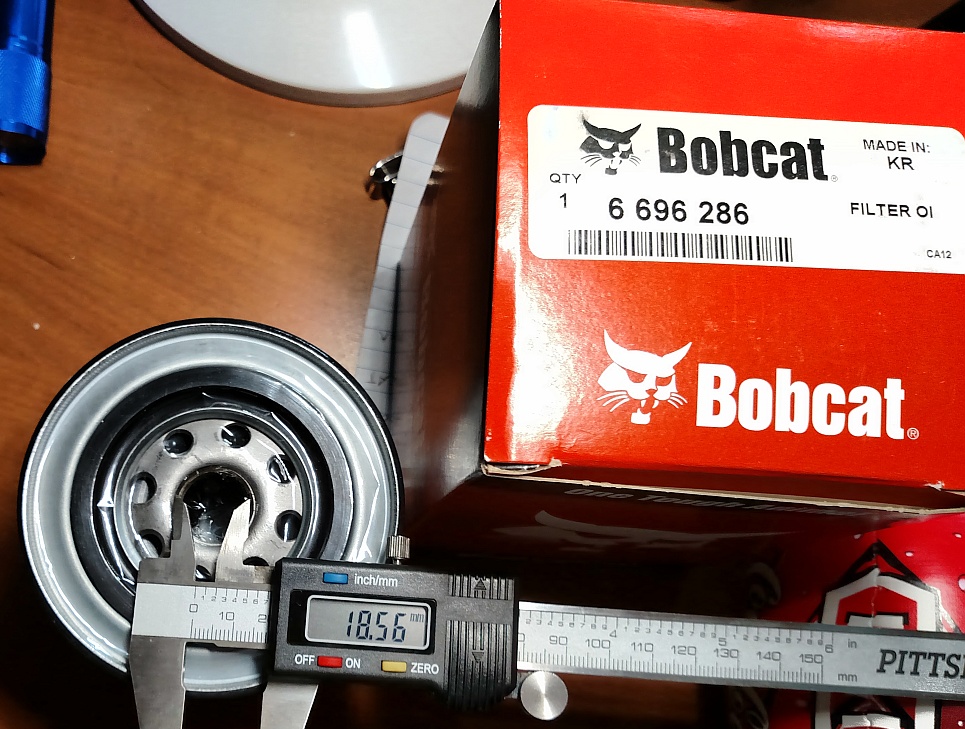

I have an oil filter for my CT225 waiting for the next service. Here it is:
The ID of the threads is shown on the caliper. 18.56 mm give or take.
   / Oil filter doesn't fit!! Weird #42
minor diameter of 20x1.5mm femal threads which is what you are measuring specs out at 18.4mm
I'd say your filter is 20x1.5 thread'
   / Oil filter doesn't fit!! Weird #43
Ditto!
   / Oil filter doesn't fit!! Weird #44

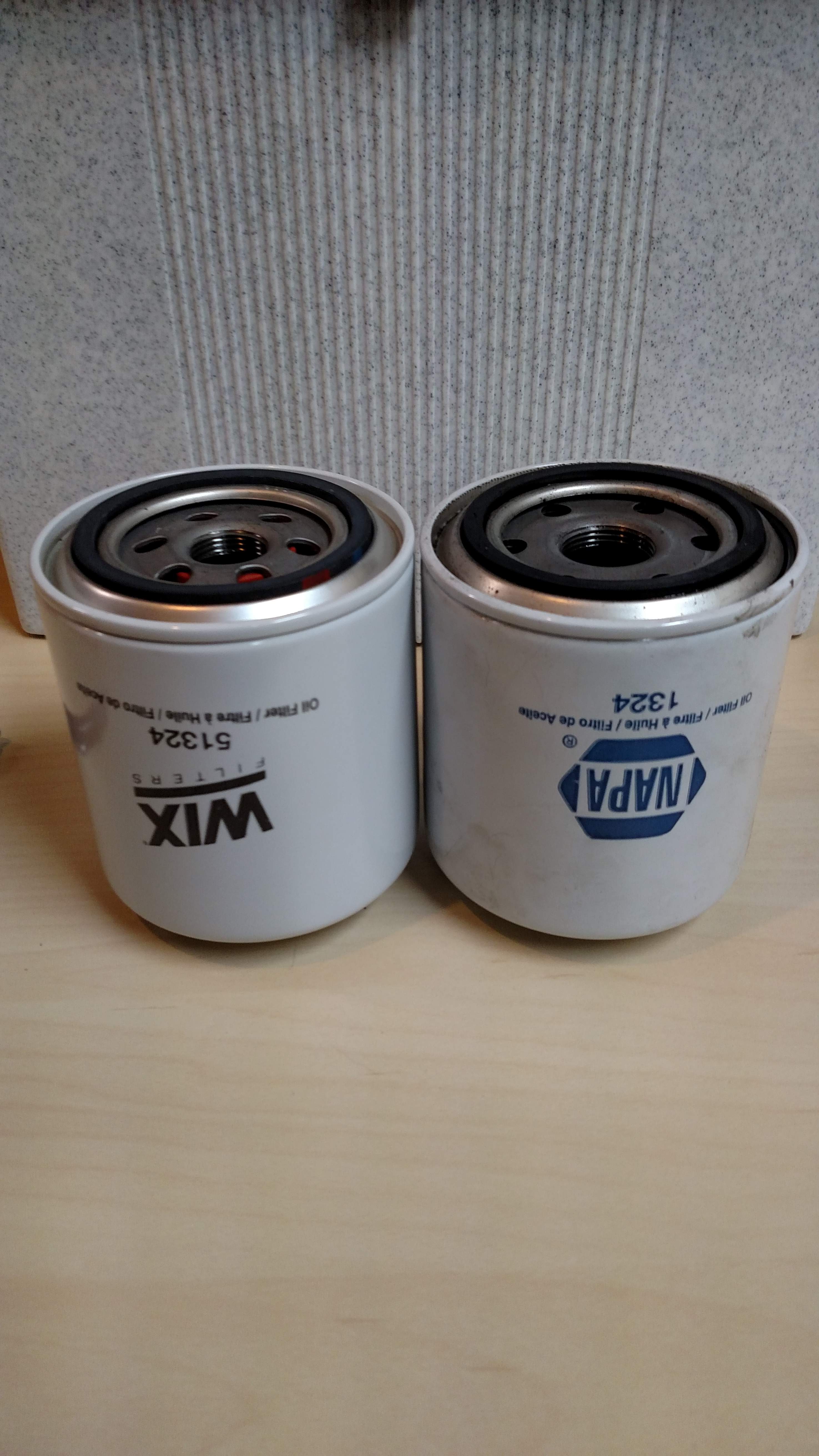

And thats exactly what we need. A picture with proof. That particular bobcat 6696286 filter matches the spec. 20mm thread. And the OD threads on the tractor-side should be in the 19.5mm range.
Would be nice to see a picture just like that with the OP's old bobcat filter, and napa filter that "doesnt" fit

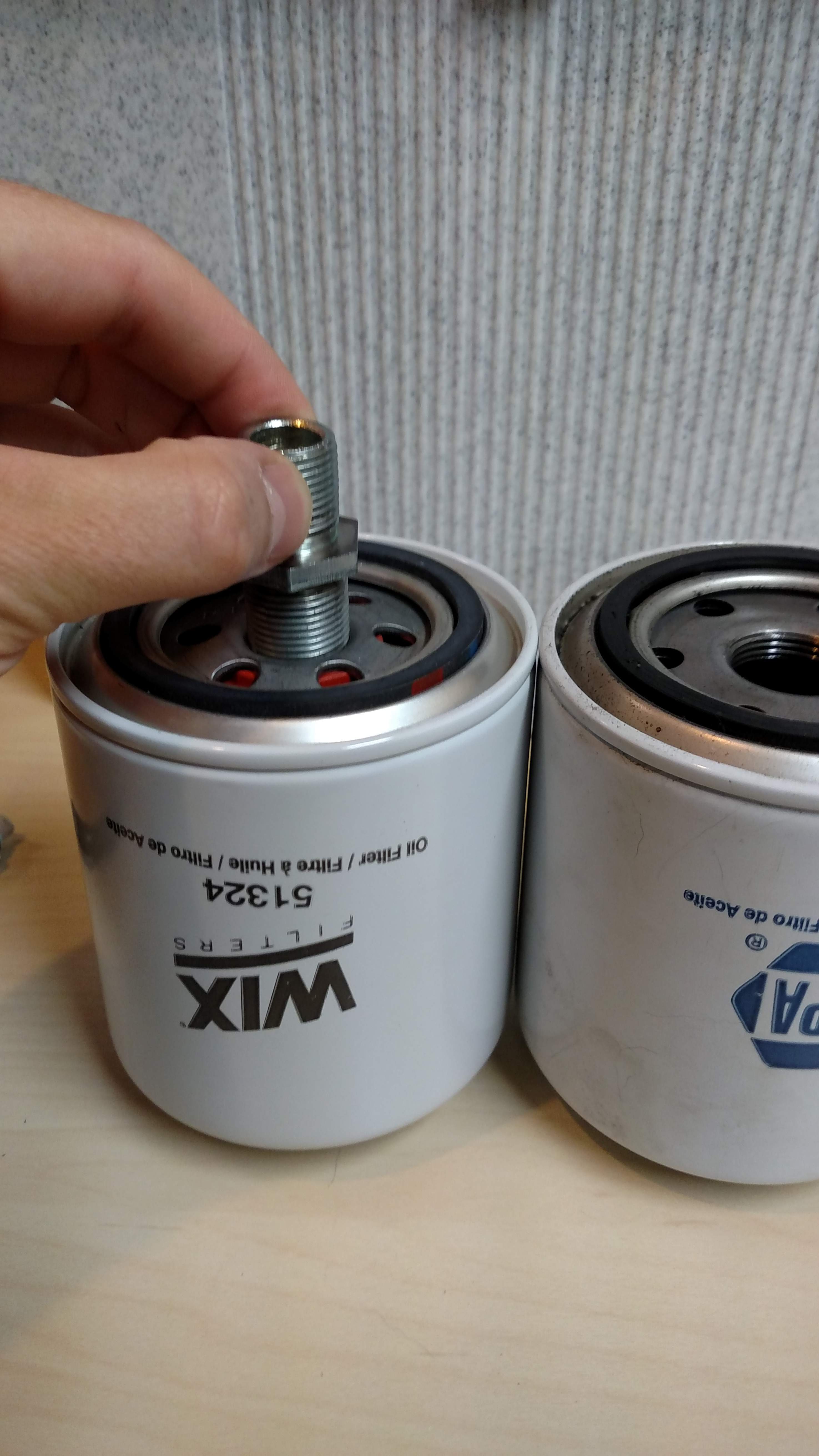

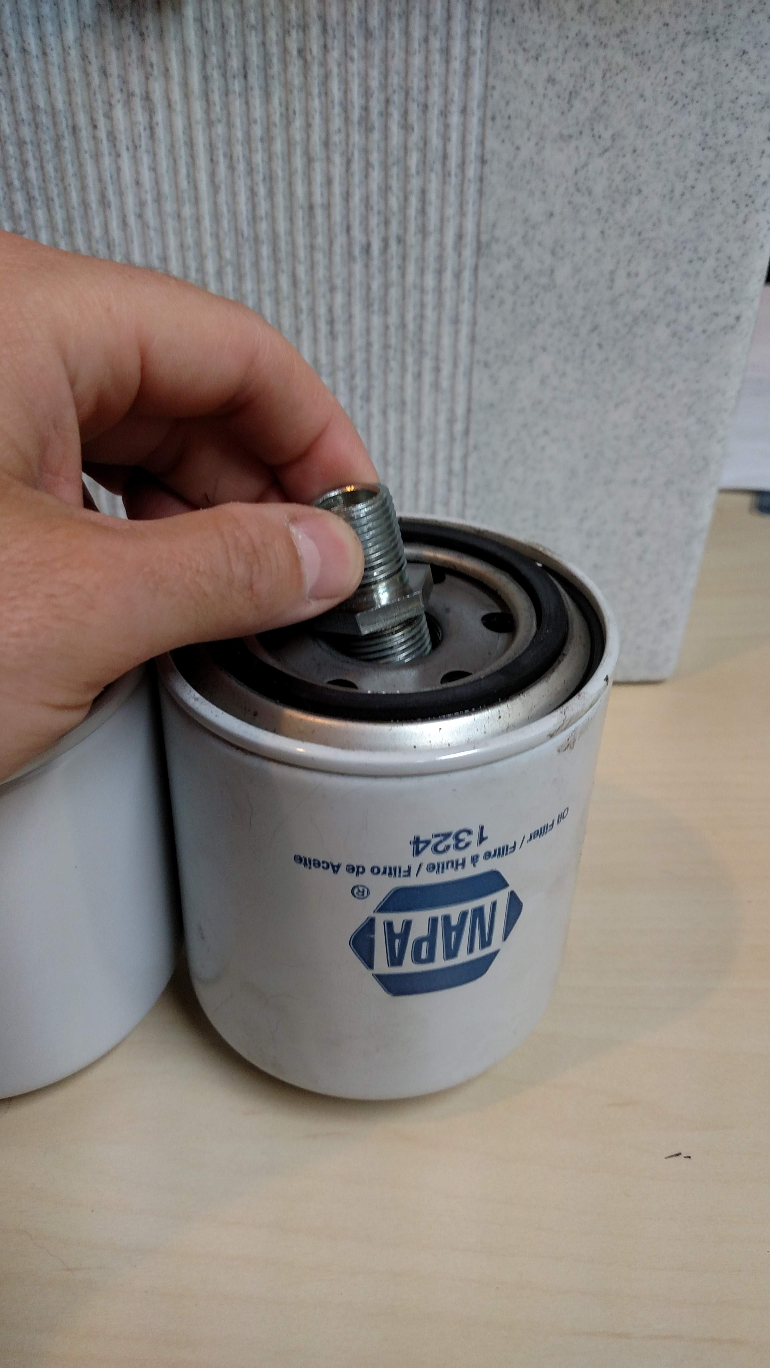

Well, thanks to you guys, this is figured out. I'm an idiot. I shouldn't have believed the guys at the parts store. They had the original bobcat filter and the new Napa filter. They never figured out that the Napa filter was built wrong or mis-labeled. They even had the wix beside it, just like in the photos, and a vernier caliper, and a book telling them what the dimensions should be! There was 3 guys trying to figure it out. I shouldn't have taken their word for it.
I also never thought to measure the threads and look them up, which would have been an easy way to check. Duhh.
Thanks and sorry for all this crap. This thread is now junk.
New Wix 51324 measures +/- 18.5mm. New Napa 1324 (misprinted?) measures +/- 22.1mm
Thanks to you all.
