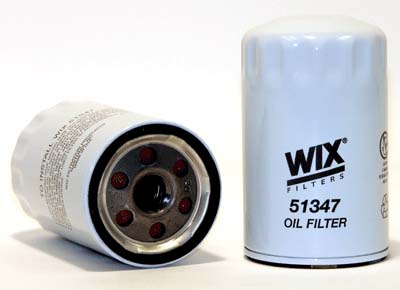

If you must have a BIG oil filter, use this one - it's almost 5" long!
Wix 51347 & Napa 1347 Oil Filter
Wix 51347 & Napa 1347 Oil Filter: FleetFilter Secure Store - Wix, Fram, Baldwin, Luberfiner
