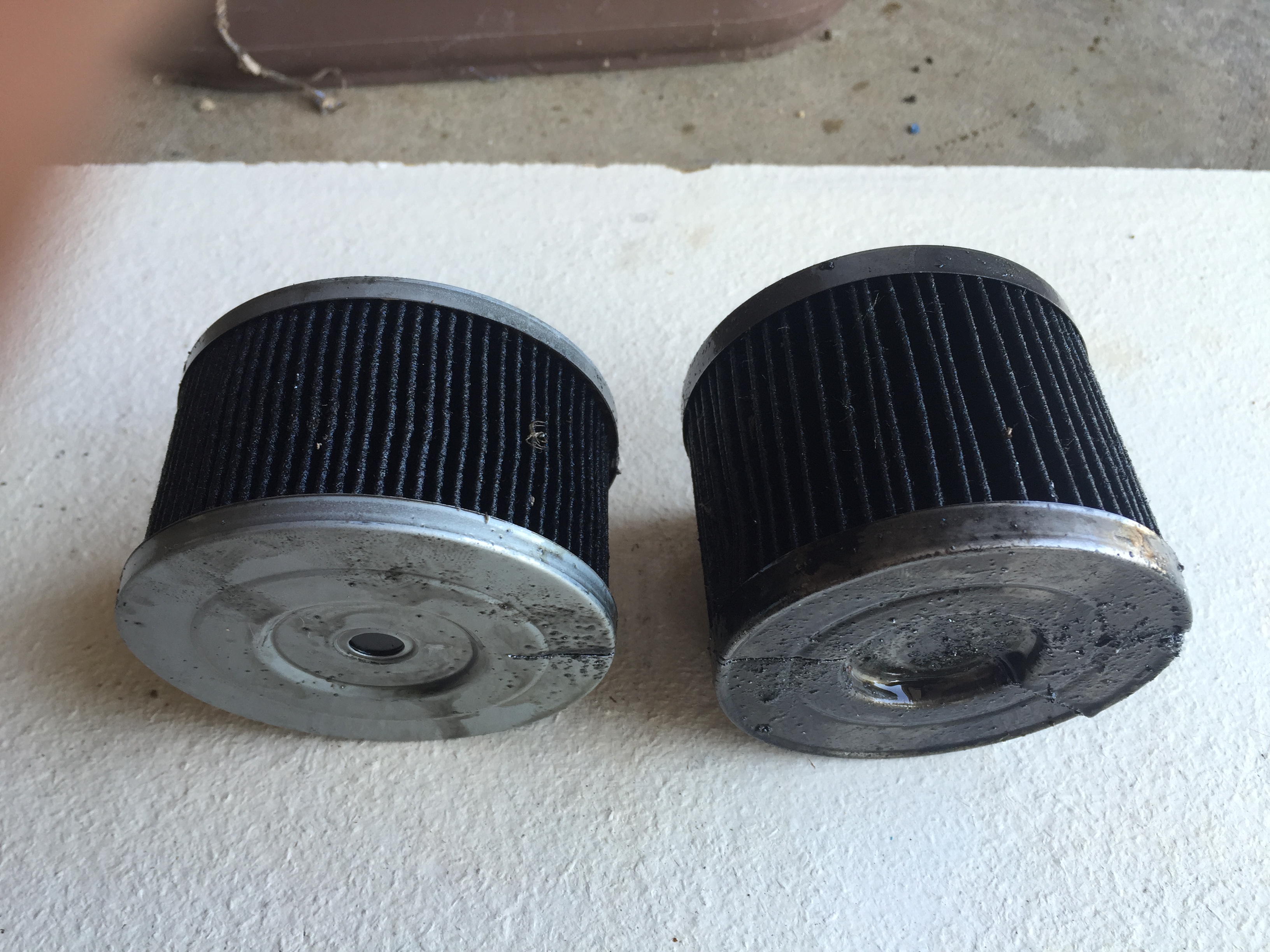

As promised (a fairly long time ago) here is a photo of the stock oil filter for my Branson 3520H on the left and a replacement filter (Wix 51626) on the right. I installed the replacement in a pinch until I got the stock replacement filter.
Besides the replacement filter being larger I didn't see any appreciable difference in their construction.
