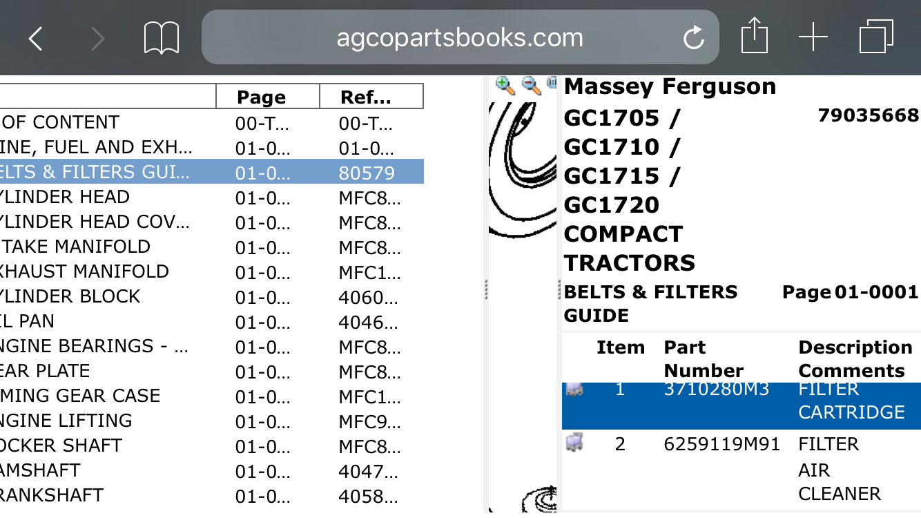

   / Oil Filter Help #5
As far as the stock part number goes, you can simply look on Agco Parts . Com.
Press the guest button.
AGCO Parts Books
   / Oil Filter Help #6
This is it.
