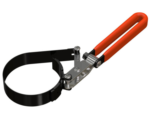

New 26xlMax owner here. Trying to do the 50hr oil and filter change. I cannot for the life of me get the oil filter off! Whatever gorilla at the factory put that thing on tight. I am unable to get a conventional filter wrench on it due to the limited space and can only get one hand on it to try the manual method. My JD 870 is a piece of cake compared to this thing. HELP!
Paint holds them on. Use a chain wrench. Don't skewer the filter with a screwdriver in case you have a magnetic rod up the middle of the filter that is part of the filter housing assembly.

I like the socket oil filter wrenches. They grip harder the more pressure exerted. I would not hesitate to attempt to use a battery powered impact and extension on the socket filter wrench. The cheaper ones don't get to 300 ft lbs but the vibratory action might be enough to loosen the filter.

They aren't on any tighter than normal, but the paint that is applied after the fact makes the OEM filters a pain to remove.
That said, the chain wrench is the best tool.
Not the filter pliers.
Not a filter socket.
Why?
Because when the filter deforms a pliers and filter socket lose efficiency whereas a chain wrench keeps working and the first oil filter will likely require enough force to remove that it will deform.

Even a band type filter wrench crushed mine. That sucker was on there to stay and it's location and limited space didn't make it any easier. I just barely managed to get the wrench on it.
I had to use a plumbing type strap wrench on my second fuel filter because there just wasn't enough room even for a filter wrench. I could just manage to work a strap around the back side of the filter. It dented it but didn't crush it like the oil filter. The first fuel filter was easy once I figured out that it wasn't a spin on like the book leads you to believe.

I'll concur that paint will add to the problem. But many testimonies can be given of problems removing factory installed filters that have not been painted over. Clean o-ring, clean metal, no oil film = disaster. I also don't believe the factories will spend the resources to overtighten filters. Simply not necessary and would add to production costs. So would taking the time to lube the gasket. :(

The first tool I tried based on suggestions from the group did the job. IMG_0579.JPG
The Harbor Freight "GripTech" with a 3/8 6inch extension. Didn't take a whole bunch of effort once jaws tightened around the filter. I lubed up the O ring well so hopefully the next change will not be such an ordeal. Hooked up the snowblower as the flakes are starting to fall here in the Cascade mountains of Oregon.
Thanks to all who responded!!
