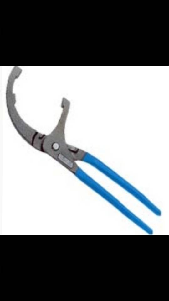

Big pipe wrench works wonders on a oil filter if you have room for it.
You need leverage, the longer the handle tool the better.
I bought a new mower, I could not believe how tight they installed that oil filter. I tried about everything I had and the only thing that worked was a 60 year old heavy 28 inch pipe wrench..
