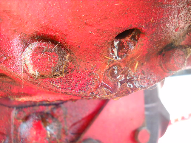

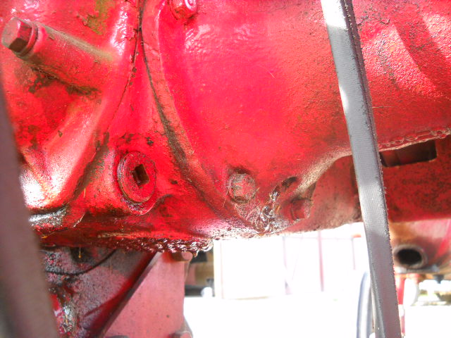

I have a mccorick farmall super A I'm not sure on the year hoping someone might be able to tell me that and also I have a some kind of oil leak coming out that looks like a casting hole ? I put 3 pics on here to look at. I just got this tractor and dont know much about it

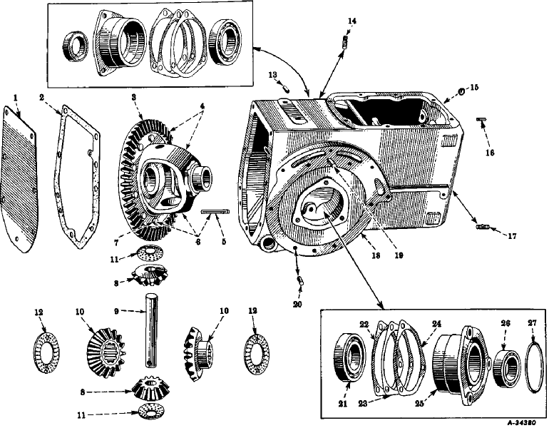

More then likely the axle seal in the transmission case side. #26 in the lower right hand corner.

Thanks DJ54 that digram is great help I have another ? for you can you tell me by the pic about what year my tractor is or what years of parts that will interchange.Also looking for a good web site to get seals and bearings.
Before you go and start pulling the axels, trans, etc to find that leak...I have question...When was the last time you changed the trans gear oil? Reason I'm asking, is if its been a bunch of years/or you don't know, you may have a couple of quarts of water sitting in the bottom of your trans/diff.....which will raise the gear oil level to the top of the seals....which then makes it appear that the seal is bad...suggest a gear oil change may be what you should try first...if you do let is set for a couple of days then slowly take out the drain, see if water comes out first.....if it does, its probably your culprit...BobG in VA
