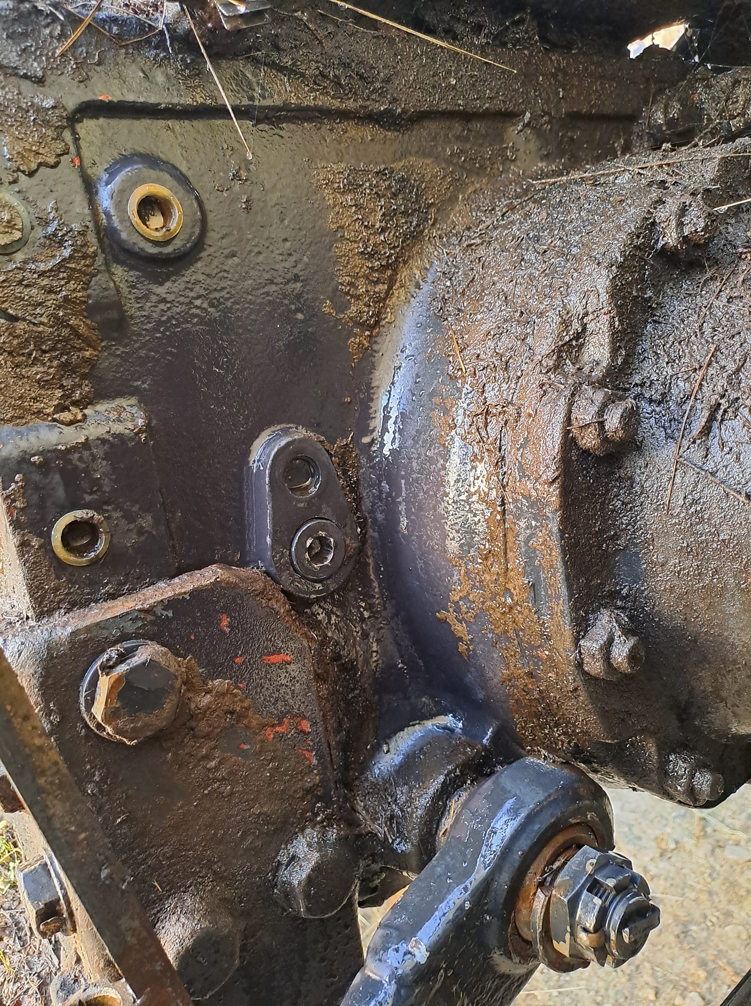

Hello all,
Until now, I only found a screw under protection covers next to the shift levels, but no oil dipstick.
Does anyone know where to find the oil level for this tractor?
   / Oil level on a Lamborghini 550DT #12
Look for a plug on the right hand side of the transmission case.
You will need an allen wrench to get it open, it's flush with the case so a bit hard to find.
Fill the case until oil comes out of the hole of the opened plug.

Thanks for the help,
Is this plug next to the gears shift?
   / Oil level on a Lamborghini 550DT #14
Keep in mind, I'm guessing about this because I believe your tractor is SAME built.
You will find it on the right side of the transmission about half way up, and look for it from the back of the tractor.
You check with the 3 point hitch all the way down.
SR
#15
Thank you all for your support.
@Sawyer Rob the plug was were you mentioned, it was hidden by some oil.
Here is the place for future help.
