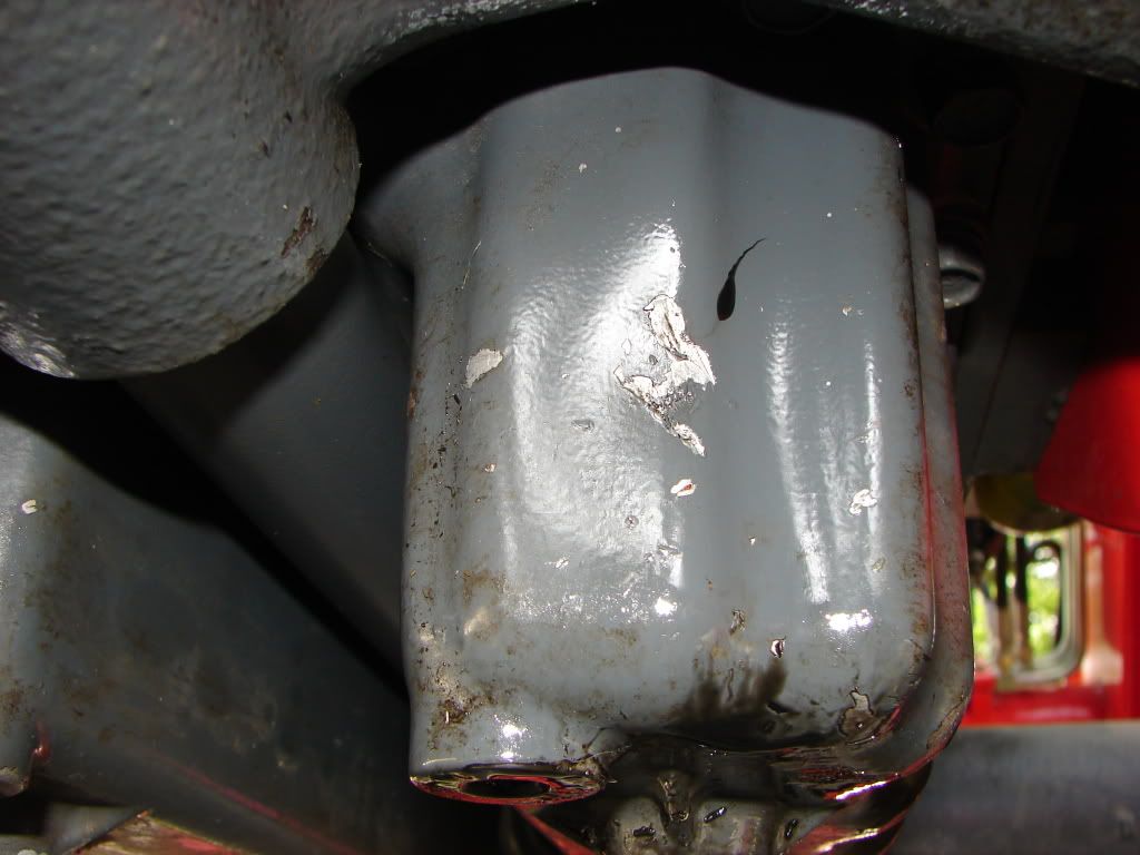

i have a L4400 4wd. I guess while brush hog-in i hit a rock and sent it into the oil pan. At least that is my best guess. well the pan cracked next to where the dent is. I was wondering what is the easiest way to remove the pan. the front shaft runs right under the pan and i don't see how i would take it out. It has a plastic sleeve that covers the shaft and looks like it goes into the housing. kubota wants $810 to replace it. 250 for the pan and 69.95hr for labor. said it would be a min of 8hr if they didn't run into any problems. Also thought about seeing if someone could weld it but haven't looked into that yet.

Judging by the bosses on the bottom of the pan it's a casting. From the dent and the smeared metal I'd guess it's aluminum.
/ Oil pan cracked #14
Judging by the bosses on the bottom of the pan it's a casting. From the dent, the smooth surface finish where the paint is still fresh and the smeared metal where it isn't, I'd guess it's aluminum.

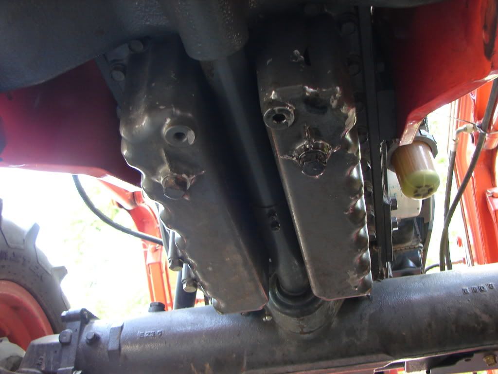

That is one very interesting setup, splitting the pan like that to run the driveshaft, interesting and very ingenious.

/ Oil pan cracked #19
The 1600 Series MF are like that too, except they have a crossover tube between the 2 pan sections, guess to help keep oil ven between the to lower halfs.
df.
Yes, it looks like an aluminum die casting. The material color says aluminum too. If it is a die casting, it may not be a weldable aluminum alloy - the heat may just burn it away and make it worse.
But the JB Weld idea would be inexpensive, easy, and probably work very well. Rough up the surface around the patch so the epoxy has some tooth to grab onto, and cure the patch by placing a light bulb close enough to keep it warm a few hours. No need to take the pan down - just drain the oil, spray some carb cleaner at the crack and let it dry. If you get the surface clean, the JB Weld will stick very well. Keep an eye on it for seepage and fix it again if needed.
