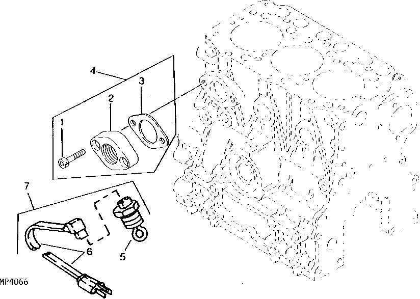

JD offers a block heater for your tractor.
Yes, they do. They also offer a block heater for my tractor (955). $73 for the "field install kit" which comprises a 1" NPT heater and a cord. I sourced the same thing from an "other than Deere" supplier for $36. As usual, go green and take it in the shorts.... or excercise your options and keep a lot more green in your wallet.
