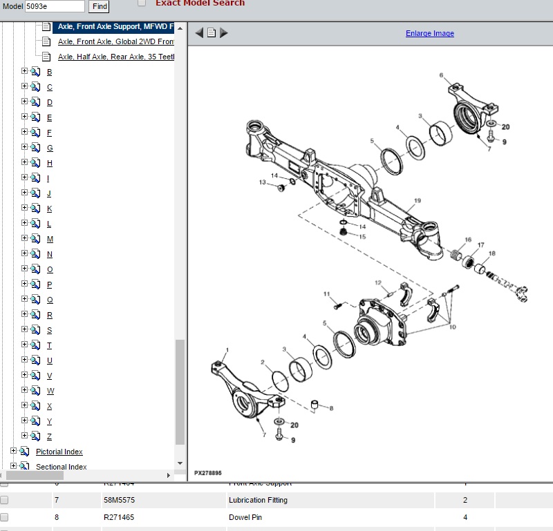

Should have a couple zerks on the trunnion, a few on the 3 point hitch links, and two on the rear axle bearings..
Are there other places that you think should have them?
I found the 1 on each side for the axle bearings and I found the 3 on the 3 point hitch arms but what I didn't find was any on the ball joints or steering links or whatever you want to call the front end components, it's all sealed, my other tractor has greaseable front end components everywhere, so yeah, I felt like there was other places that I should have found them.

   / Oil plug on 5093E oddball #14
There are two on the front axle (called trunnion in operators manual). Key item #7
