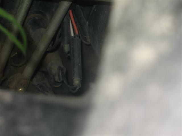

drivers side rear wheel

Jim,
Busy last few days so could'nt get back to my Dynamo Hummmm. Off today so will see what I can test. Hopefully those safety switches just pull off without too much trouble or I might end up bypassing some of them.
johnnylight,
Will check for any loose / disconnected wires although last time I was under the tractor did not notice anything.
Thanks to both of you for responding.
Vic
   / Oil Press Light Out = No Start !!
#14
OK.....found range selector lever safety switch. Pulled rubber boot off & jumpered terminals. Tried to start but nothing. This time however, I heard a buzzing sound when I turned the ignition switch all the way over. Tried it 3 times with the same sound. The fourth try & the beast fired right up. I let the tractor run for about 20 minutes just to recharge the battery a little. While it was running I disconnected the jumper on the safety switch. Turned it off & figured that was it.....probably won't start again. But low & behold (gosh golly gee) she fired right up again. Tried it three more times & ignition each time.
HOWEVER, now each time I turn the ignition switch half way just prior to starting I hear a distinct CLICK. Sounds like it is coming from solenoid. Do you guys think my Solenoid is on it's last legs ??
Vic
