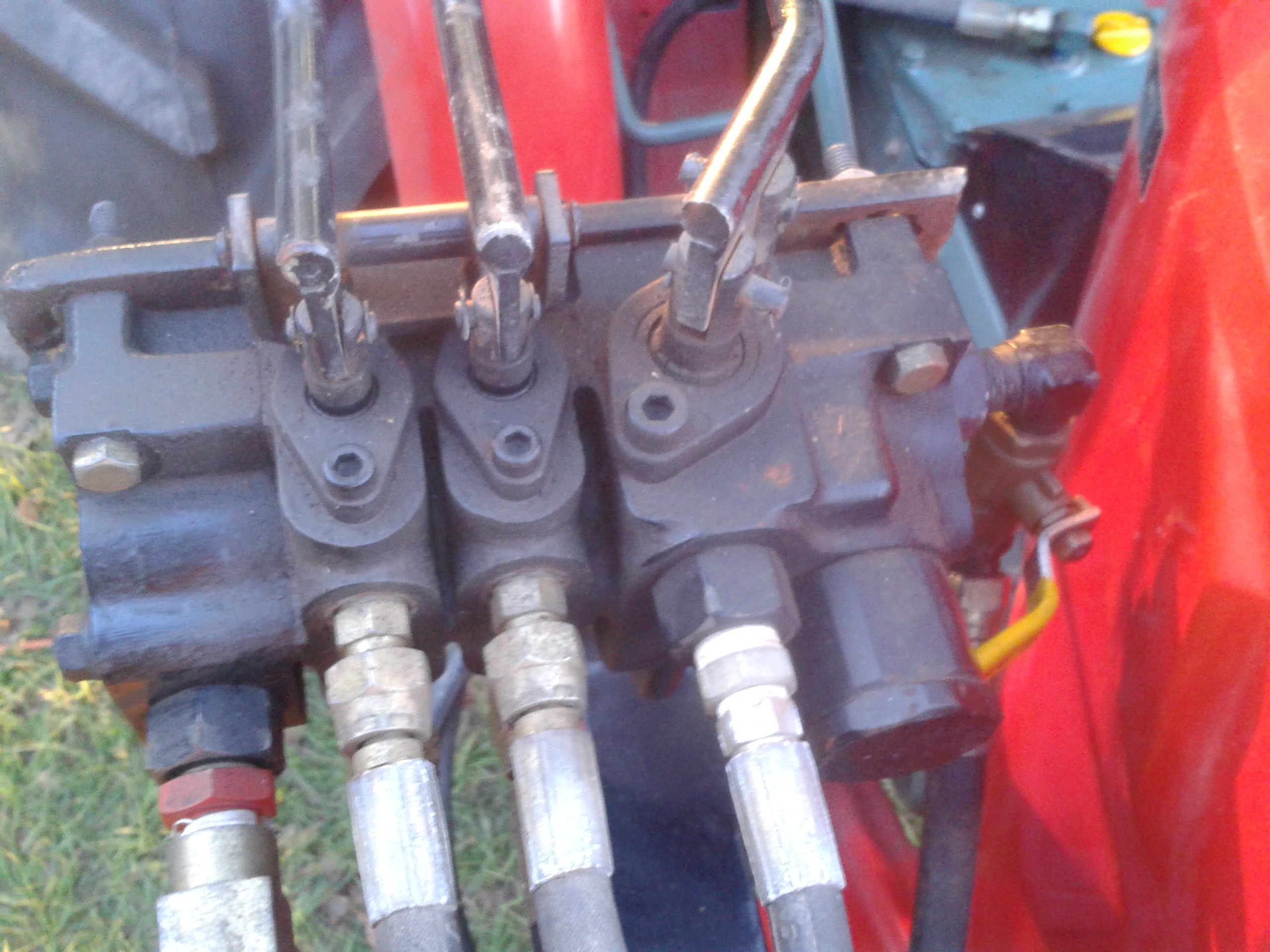

I'm now also confused about the third lever beside the loader lift and tilt controls
I played with it today but of course that was after the oil ran low
It's inlet is from a Tee before the oil enters the manifold
Can't see what it controls ... it seems to be a shut off ... clicks on/off

I still haven't worked out what the third valve does if anything
(My bucket is just lift/tilt, not one of those 4 in 1 with the grabber)
The valve seems to be an isolator between the manifold to the TPL
To complicate matters, a ball valve has been fitted inline just beneath it on the way to the TPL
I can lift the TPL only by closing this ball valve

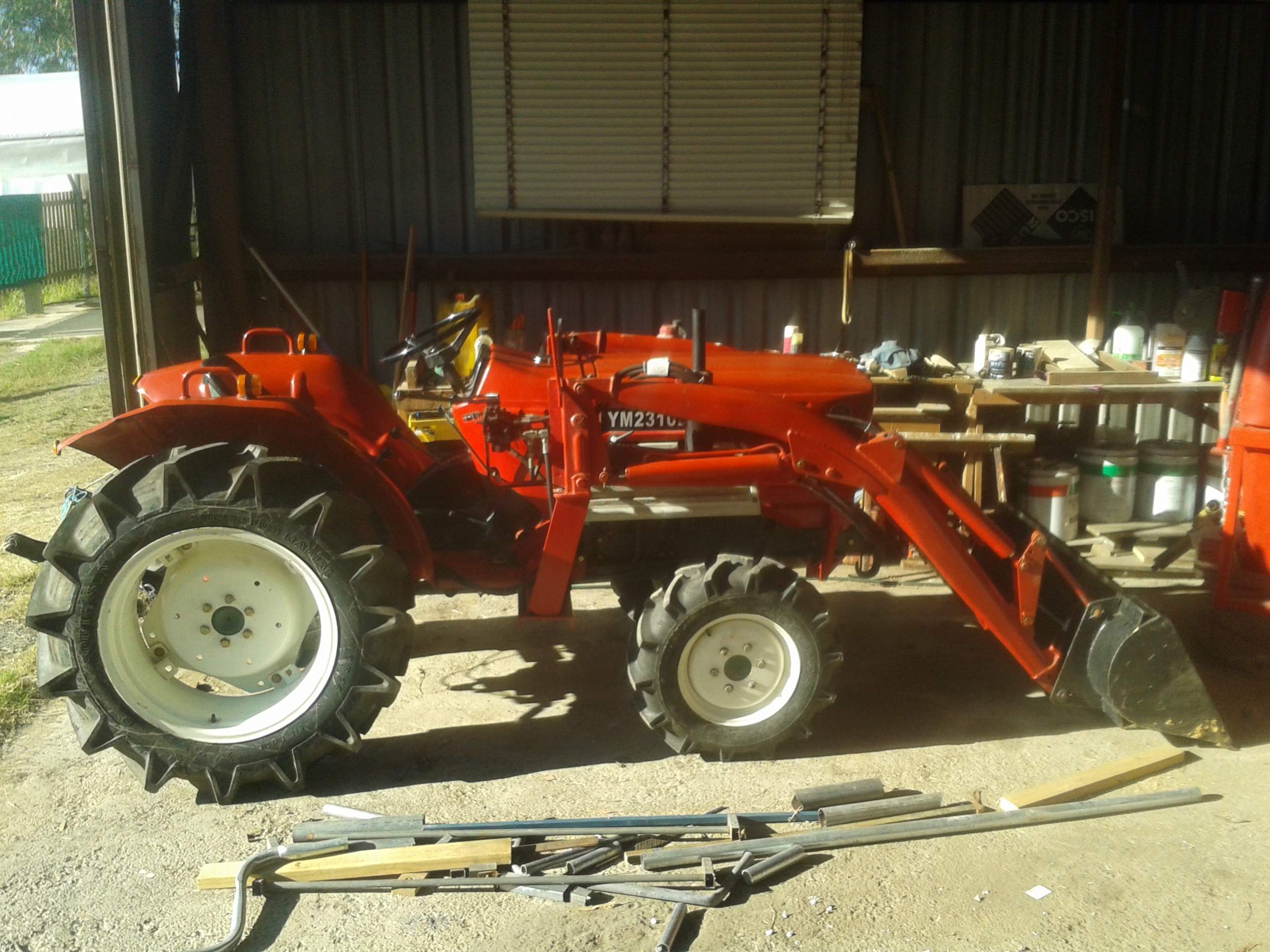

This is the tractor with what seems to be an original front end loader
Let's see if I uploaded this correctly

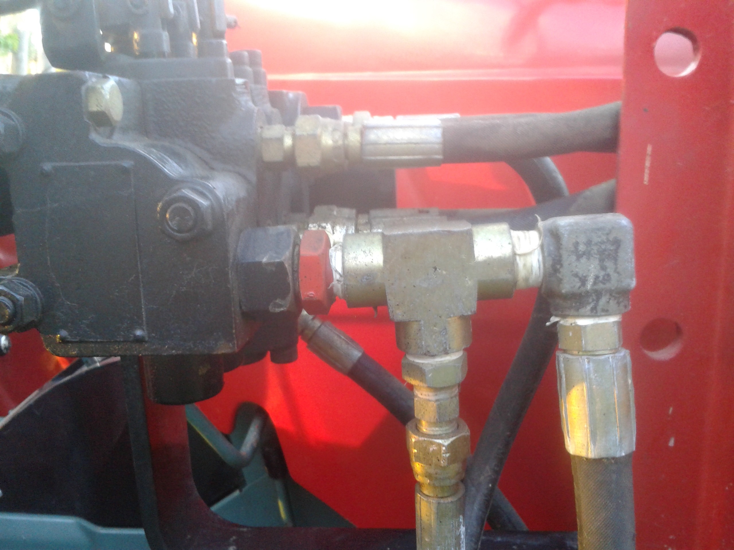

And this is the valve manifold
The mystery valve is on the extreme right hand side in the picture
Beneath it inline is the ball valve that needs closing to activate the TPL `lift'
   / Oil ran too low - Need to fill and bleed the system
#9
The valve is fed from a tee that brings in fluid from the case
The hose from the bottom leg of the tee loops up and enters the manifold at the third valve

Not a Cold climate old Queensland, nice and warm. I use Peak oil's (Caltex) Agritrans in my 1500 and found it excellent. Maybe the plumbing is a bit screwed up? They installed the ball valve to get flow to the 3PH?
