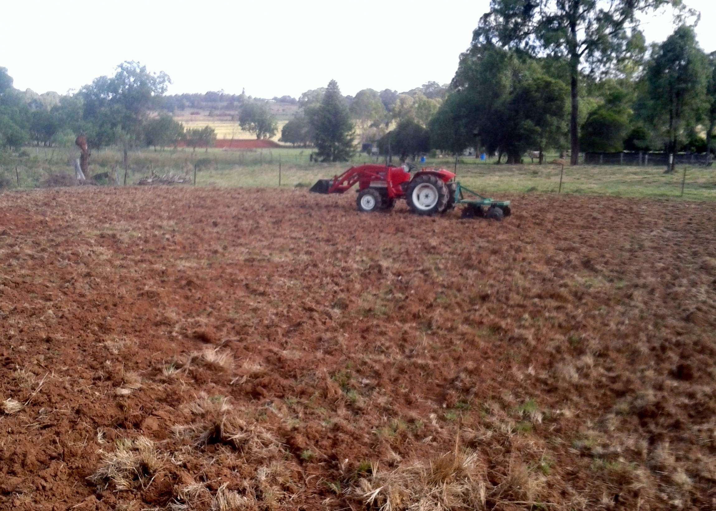

OK, here is the latest `good' bit of news ... from parking the tractor last night
I had already let down the (3PL) set down the disc harrows on a wooden pallet
Then I noticed the bucket had some dirt and weed caught in it
So I lifted the bucket a touch and curled it forward ... and as I curled it back, lo and behold the 3PL went up
The 3PL lever was in the down position
But I can now avoid high pressure building up and never close that `d@#%*ed' ball valve
It's not likely I will be needing to curl the bucket up while towing gear
So I'll slide the 3PL lever Up and pull on the curl lever
The 3PL lever lets the 3PL down
Problems solved

Thanks Darryl and thank you Winston for all your generous `remote help'
The further I go into it the further I've got out of my depth
I'm now comfortable at least using the tractor as it is (safely) until I get someone local to look at it for me
There's too much going on for me to work out:
The dud 3rd valve, that ball valve, pressurised fluid goes first to the 3PL, and now the 3PL going up when the curl lever tops out
And all this with what seems to be an original Yanmar loader and control box
Still, I'm very happy with this little tractor.
It's doing a wonderful job ripping and discing long days (dense red clay soils)
