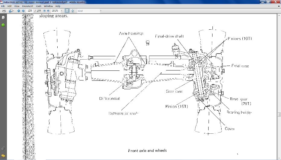

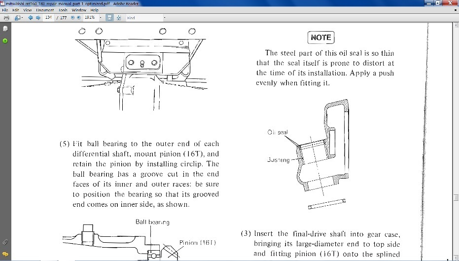

I have a Mitsubishi MT 1601D that started an oil leak at the front axel wheels gear case in one side.
Does any one know where to get the right Oil seal for this gear case? As i expect the other side to start leaking also if not both is changed. no part nr in the repair manual. i would need a couple of them ;)

Pull it, read the numbers stamped into it or measure it and order some.
Lots of places to get seals many specifications from.
Not sure if yours are the same as mine, but I'll see if I can pull the numbers.
Your other alternative (for a while) is to go to a thicker oil; what were you currently using?

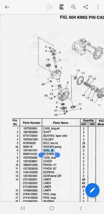

This is from the MT180D parts catalog, since you have a Grey MT1601D you have a mix of MT180 and MT160 parts.
Valley wants $38/each
Southern Global wants $24/each
If you go direct to a seal manufacturer it will probably be about $5-10/each

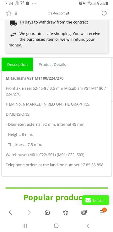

thank you :) as im in Bulgaria it might be hard to use US dealers, but i have found something similar from Romania (or the repair shop im using have found something that might fit but the original is 8mm high and the replacement they found is 5mm high it might not fit properly)
i will try with the part nr and see if that can help them get the correct part (as im sure the other side also will go its just a matter of time)
That second image is from a tractor supply in Poland.

I ended up ordering 2 oil seals from the Polish supplier, how ever my repair shop had also ordered 2 oil seals from Romania but not with exactly the correct specs (they where 9,5 mm High) they cut 1mm of and got it to fit so now the leak is stopped and i have 2 spares (correct ones) if i need them in the future. (the delivery time shown on the polish site when ordering was 24-48 hours BUT it it is more like one week in reality ;) )
Thanks again for all the help i received.
