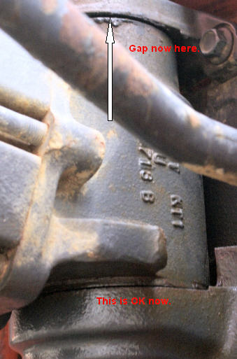

.....I am concerned about one one aspect on how the assembly looks now......I would appreciate any comment(s)......
The gap does seem a bit wide. Look at Ken's #1 picture in the thread linked above. How does your top cap fit? Does the hub turn to the left and right freely? If the top cap is rubbing, there could be a shim or washer on the bottom that should be on the top?

Here's what I'm wondering:
When I reassembe every thing, put the wheel and tire back on, remove the jack that's holding the front axle up, and put the tractors weight on the front axle; I wonder if things inside the front axle case and bevel gear case will compress, or shift upward that 1/8 of an inch.
Any thoughts on that?

I assume your tractor is kinda in the same position as my tractor in the pic in my previous post. If you grab the part the wheel bolts to and swivel the unit back and forth do you notice any slop or play? If you put a floor jack under the hub and gently lift up does anything happen? If you take the two bolts out of the top and remove the cap will the kingpin assembly/seal go up any farther then?
I would be leary of just putting the weight of the tractor on it first to see if the gap closes up. Something could be slightly misaligned causing you to break a tooth off one of the gears.
Ken

There should be very little vertical clearance in the axle stack. It it moves up that much with the weight on it, something isn't right.
Your post about taking it apart from the bottom gave me an idea - make sure that both parts 110 and 120 on the attached diagram are above the gear. If one was below the gear (or missing) it could cause the extra gap.

Here's what I did over the weekend.
I had the 1/8 inch gap with the "B" side facing down, so I figured, what the heck, I'll flip the rascal over.
So I disassembled again from the bottom and then reassembled with the "B" side facing UP.
I still got an 1/8 inch gap.
About then, I'd had enough.
I took the tractor off the jack.
The weight of the tractor eliminated the 1/8 inch gap (where it was) and now created a 1/8 inch gap at the heavy duty cast cap with the two bolt holes in it. Please reference the attached picture.
The two items (110,120) you mentioned are present. They're little metal spacer/washer kind of gubbers.
I give up, and will run the tractor as is; unless any one else has some ideas.
It's as if the new oil seal is an 1/8 inch taller than the original, and that makes all the items/parts stacked on the vertical inner shaft an 1/8 inch taller than it used to be.
I appreciate the time and effort given by the forum members.

.......The weight of the tractor eliminated the 1/8 inch gap (where it was) and now created a 1/8 inch gap at the heavy duty cast cap with the two bolt holes in it........
Is there clearance in the holes? With the gap on top would the cap move down if the bolts were loosened?
   / Oil Seal Left Front Axle Bevel Gear Case - L5450
#20
There is absolutely NO wiggle room related to the two bolt holes in the hefty cast cap.
