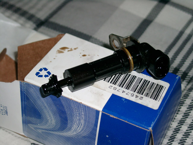

   / Oil siight / Temp guage #28
Here is a link to some info about a GM oil level switch. It is not a pressure switch, just a level switch. It looks like it goes into the side of the oil pan.
Stroker Engine Build Oil Level Sensor Photo
Below is a picture of a Pontiac oil level switch with part number on the box. Again, not a pressure switch, an oil level switch.
Here's one for a malibu.
RockAuto Parts Catalog
Here's one for a Corvette.
There are lots of them out there. Some are under $20.00. Seems like one of them should work. Someone just needs to buy one at a junk yard and figure out how it works. (not me, of course). :D

   / Oil siight / Temp guage #29
Dear MR,
They are basic float switches. (KISS) I think that there are some assumptions about how steep an incline you can run a corvette on...
On the other had, if you mounted it just above the normal oil intake to the charge pump, would you really care why it was that the charge pump was about to suck air?

#30
That looks like it should run vertically (the engine switches) but runs horizontal? I would say that Ponytug and MR have the solution.... I have to replace all my intake hoses this spring so maybe I will drain the tank and do some drillin....
Question, If you put it above the intake, would the fluid pull (the sucking) effect the switch? I am sure there is a lot of pull on that system if it is churning a tank over once a minute... (1850 = 18GPM)
