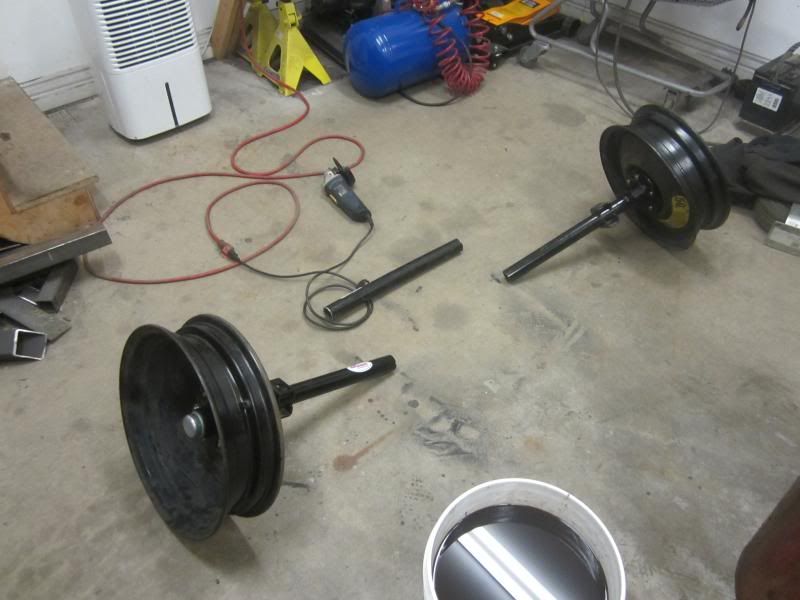

I'm going to use the tires that came with the old dump trailer... they're 6.5R16s... weather cracked, so I picked up some inner tubes.

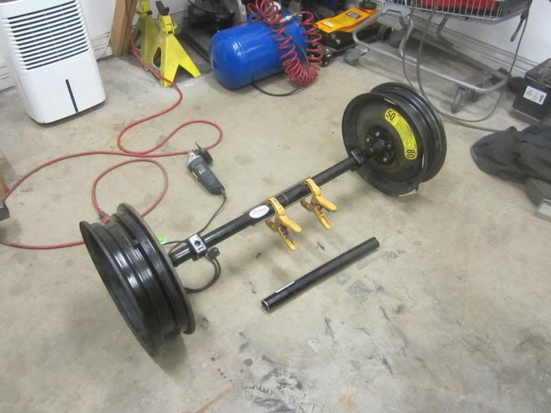

Unfortunately they're on 5 on 5.5" wheels, and everything trailer at princess auto is 5 on 4.5"... so after a bit of searching I found that Jeep Cherokees had dummy tires that had 16" wheels with 5 on 4.5" pattern. My friendly local jeep shop gave me these...and just to see if I could, I dismounted the tires.
4' would have probably been ideal for this, but the 5'er was on sale for $99 from $180... so this'll get cut down.

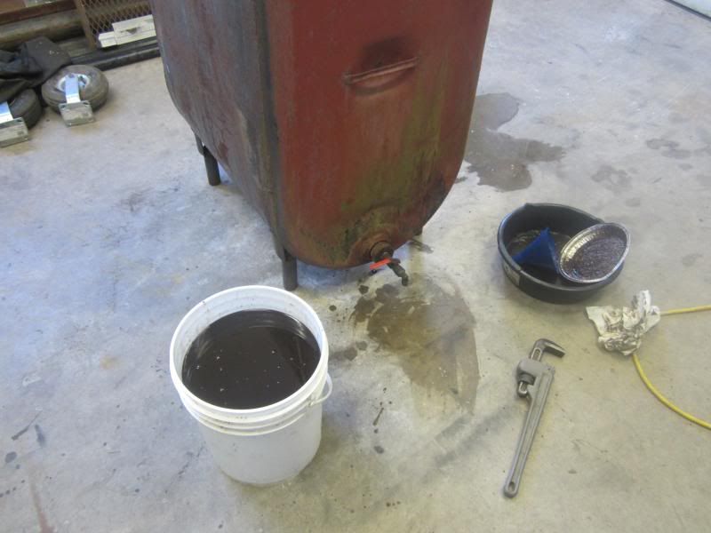

I took all the fittings off and drained 4gal of rusty furnace oil out of it today... only to discover a huge chunk of ice in it! LOL Drug it in the garage to melt.

Day two of draining it. I took 4gal of oil out yesterday (not shown), and noticed some ice inside... so brought it inside to melt... took that much dirty water out today.. with more ice in there. I guess 24 hrs wasn't long enough to melt it all. LOL

I sure hope I got the measurement right!
30" outside spring pad to outside spring pad (same as tank), and 49" outside wheel to outside wheel.
It's 1 3/16" inside, so shouldn't have a problem finding a piece of tubing at my metal supplier as a sleeve.

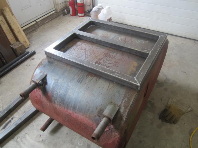

Ok, so last night I made this;

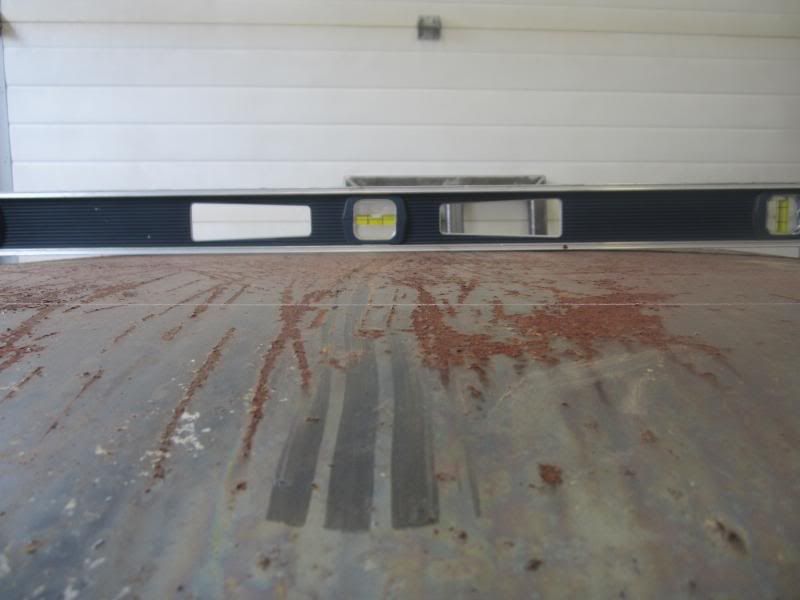

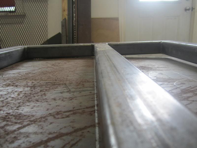

...and encountered my first problem; the long side of the tank isn't perfectly flat. The frame was made on the floor... so this was the result;
It seemed like it was just the center that was bulged out a little
...so what I ended up doing was welding the one end... then kneeling on the opposite end to tack it. Worked pretty good. It kind of "poped" down. If that didn't work I had an idea to drive the Jeep's bumper over it and using the high lift jack to push it down.

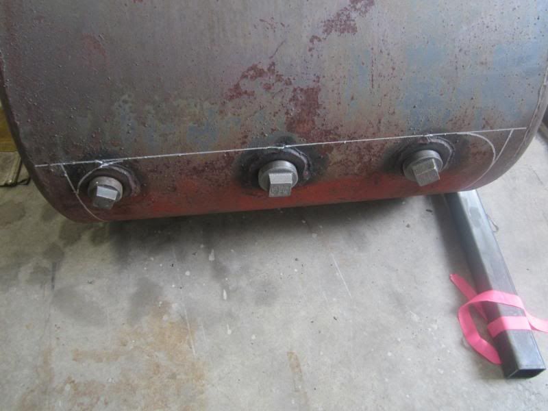

Also scrounged up some plugs from work. I was going to cut these out and make it the open end... but the other end will give me more options
So I'm a little disappointed in how this is going... I should have made that frame longer and built up to the curve of the tank. As it is now everything's going to rest on 12"X30" of frame. 12" front to back. Seems like alot of leverage... but I think I'll keep going.
