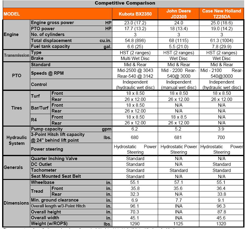

Jay,
Here are the comparisons, (the new specs on the Kubota is actually heavier 1322 with ROPS). I am having trouble "justifying" the New Holland over the Kubota (same dealer and a good one) @ 1,000 dollars less! Dealer says the difference is in the rear end, CAST IRON assembly and "bull" gears on the NH TZ-25 vs. Cast ALUMINUM housing and Planetary gears on Kubota BX2350?
He says it is worth the diference (salesman ) :)
Kubota has 42 months vs 60 on 0%, but $1,000 dollars lesds is huge!

   / OK Come on guys WHICH TRACTOR ??? #14
Spec wise, I think the BX2660 is a better comparison to the TZ25 than the BX2350.

DGL,
which specs, the Kubota weighs more on the new specs. I guess the qustion is, what can the New Holland do for me, that the Kubota will not do?
I think it might Lift more in the bucket, but the New Holland site does not give detailed loader specs like the Kubota site!

This where the companies start to skew the "data" with the Sales & Marketing influence. I do like all that glossy literature :rolleyes::
The hyraulics for a NH TZ-25:
Pump Capacity: 3.9gpm
Power Steering: 1.9gpm
= 6.2 vs. 6.9 for the Kubota where they probably combined both capacities.
I agree with Soundguy as to cast iron vs. aluminum.
You should really sit on both, operate both as much as the dealer will allow, and really go with your "feel"; both are good tractors.

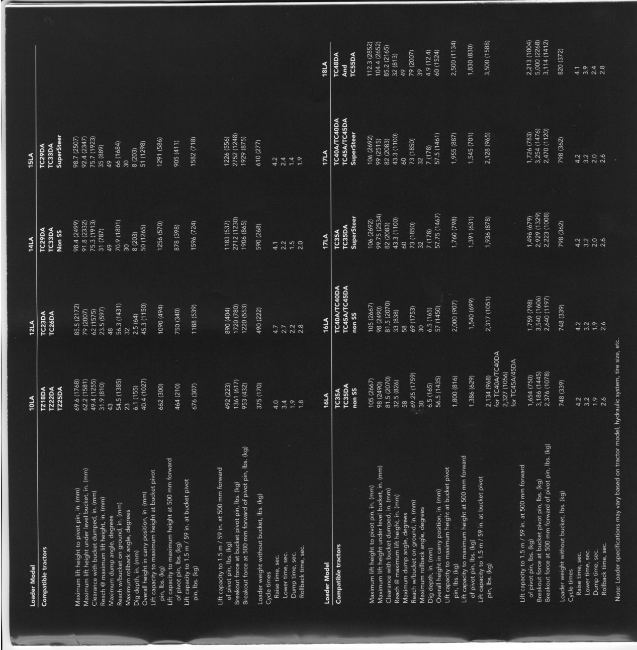

rkummerer: As I stated before I do collect that glossy S&M literature :eek:. Jay :D

Sorry about the scan; I would have lost scan quality if I played with the image. Jay :rolleyes:
