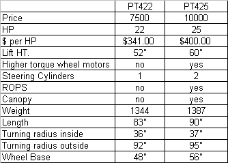

That is the way it works for us. The only time I notice a loss of hill climbing power is after mowing for an extended period. Brush hog will do it too, in thick grass, but not as much when just chopping sticks. This is one of the primary reasons I went with the 425 over the 422... the factory told me the 425 would spin the 60" mower better than the 422.
I would say, if you have hills to deal with, or you want to run the 60" mower, try to come up with the funds for the 425.
Let's compare the two side by side...

Looking at the numbers on that comparison chart begs a question. With the 425 having an additional steering cylinder, 3 more HP, a canopy, ROPS, higher torque wheel motors, & being 7" longer, how can it weigh only 43# more than a 422? Seems to me the ROPS, or the additional steel for the lenght (that thing is made out of heavy stuff), would weigh more than that.
I, like jbman, have been "shopping" for a long time and have not pulled the trigger yet, altho I have been to Tazwell & asked questions before on this forum. I appreciate the honest feedback. I will probably go with a PT as soon as the $$ come together, but with the hills I have this wheel torque thing concerns me.
