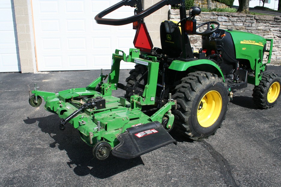

Also, can someone tell me how to hook my 3pt hitch (I have I-match) to my mower deck to move it around? Noone at the dealership knows how.

To hook your drive over deck to the Imatch, the deck should have 4 long pins on the front tabs as shown in the Deere operational video for the 2x20's here: Deere & Company Media Player
The segment showing the deck lifted by the imatch is about 3/4 of the way through.

If you don't have the buckel level indicator, perhaps knowing that the top of the bucket on John Deere's is parallel with the bottom. For me, that works better than the indicator since I can keep focused at what I'm doing.
Perhaps this photo will help with the deck if the video is a bit fast.......

Hooking the MMM to the i-match makes perfect sense now. We were almost going to try it that way but it looked like the deck would hinge on that top pin. Now I see how the bottom pin binds it and keeps it from dropping. Awesome!
