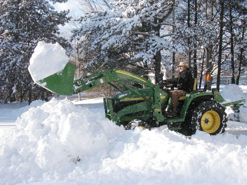

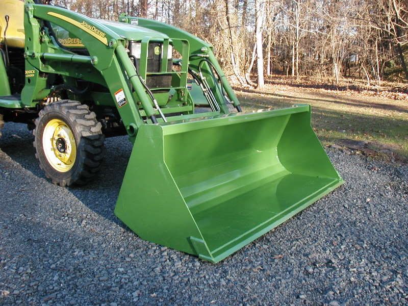

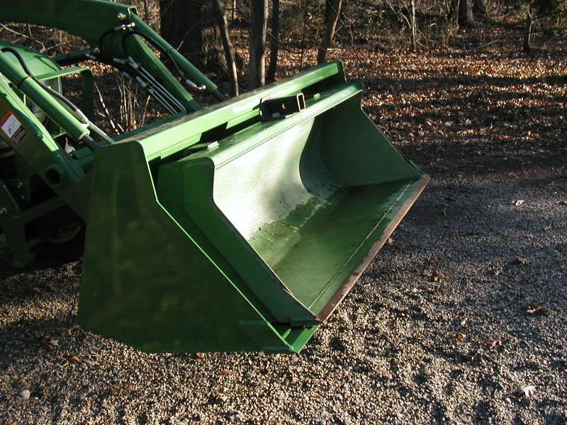

Greg,
I bought the 73" bucket just for snow work, I was thinking about making a pusher box (those things you see in every big parking lot now, chained to a loader bucket) out of an old plow but figured the big bucket would be more versatile, works great but mine does not have a replaceable edge, does yours?
I find the bucket level indicator very helpful, of course you do have to make some adjustments due to varying conditions.
Here's some pics,

The only drawback to using the top of the bucket as your level, is when it is covered in snow and ice...the kind that won't even shake off.

Unit40, Two coats of automotive paste wax on the entire (inside and out) bucket keeps the snow from sticking on or in the bucket. This is the large, high volume (lighter duty) bucket that is only used in snow. The paint stays nice as it is undercover year round. I have a 61" heavy duty bucket for everything else. It is much easier to push a 61" as opposed to a 73" bucket into unbroken ground. I ordered both buckets with the tractor so the $800 snow bucket was financed favorably. Some may question the need for two buckets, but it greatly enhances the versitality of the loader. The quick attach is sweet.
JB4310, my buckets are like yours, and I'm sure you'll vouch for the value of different sized buckets, instead of the one-size-for-all compromise. No, the Hi Vol bucket did not come with a bolt-on cutting edge, but I did install one. Be advised, the integral (welded on) cutting edge on my bucket is harder than the hinges of heck!!! Using a heavy, slow turning, Millwakee magnetic base drillmotor, with plenty of cutting oil, I destroyed 2 cobalt bits per hole, a pilot and a 1/2". I quickly decided to only use every-other bolt hole!! Also, this bucket was painted black when it arrived at the dealer. Now even your wife will say a black bucket on a green tractor ain't right. So the brand-new bucket was reworked before it saw its first snowflake. I solid welded where it was stitch welded, put the cutting edge on, and sandblasted it. It was then bathed in JD Green. People think I'm a little simple, but that's my style. Greg.
