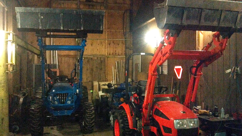

Any issues with parking my tractors with the loaders up? Takes up way less walking room in the barn with the buckets in the air, but am I causing any premature damage by doing it?
And/or, is there an acceptable time/period that is safe to leave them up?
Thanks in advance

LOL, you guys are cracking me up. I'm always a safety first guy too, once again, the point of this thread was addressing any concerns 4 damage and wear & tear to my loader, if I leave it up for any length of time.

I use a piece of angle steel as a boom cylinder lock and leave my loader securely propped up all the time in my shed. I lower the cylinder against the lock so tiewraps, velcro, etc are unnecessary. One prop is sufficient, if two makes somebody feel better, so be it. If this method satisfies OSHA as being acceptable for use in repair shops, (and it is) I'm OK with it, and this community should be as well.
This is exactly what should be done if you plan on doing something under the bucket, even just driving under it for a split second.

No, it wont damage anything. Everyone is just addressing how dumb it is to do so without making sure it cannot come down without some sort mechanical locking device.
