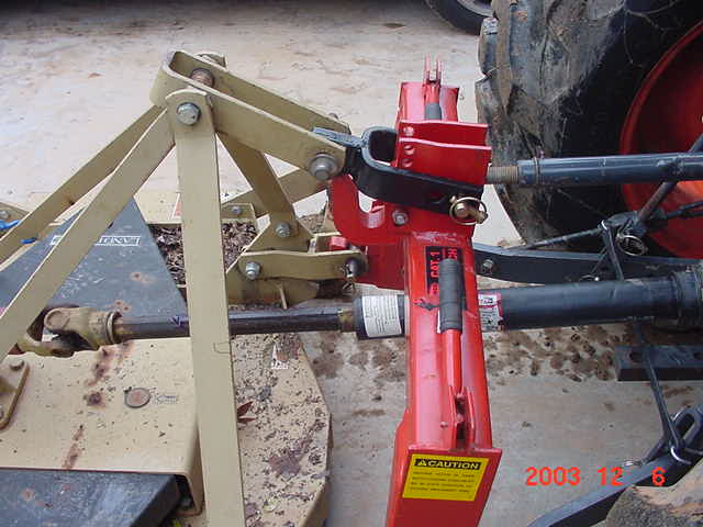

<font color="blue"> Thanks AndyMA for the pictures....I think I can make it work...my only concern is that my swivel link on the top of my mower is longer than the one on your bush hog.....so the adapter is closer to the quick hitch and the holes won't line up. BUT I can screw the top link in closer to the back of the tractor and probably make it work...but this will have the quick hitch at a slant towards the tractor.....will that be a problem you think? </font>
Nope, tilt away. Glad the pictures were helpful. BTW, If you want the Quick Hitch to be "straight" for other implements, cutting and redrilling of the yoke on your mower wouldn't make it unusable without the Quick Hitch, you'd just exten the top-link a little.

I have to agree with Beenthere. My tractor has turnbuckles that I have to loosen on both sides before I can move the lower arms enough to remove/install them on the attachment. With the Quick Hitch....I will never have to touch these lower arms....that is a big time saver....I do not care about have to get off the tractor...I don't think I could reach the release arms on the quick hitch from the driver's seat anyway. I am looking forward to trying it this weekend.

WORKS LIKE A CHAMP!!!
See the attachment, It works great! THanks AndyMA.

I notice that the back part of your PTO shield is missing. For your safety and those around you, please replace the shield or PTO shaft. Don't want to lose any TBNers. Or anyone else for that matter!

Your photo shows the hookup just as I tried to describe in my earlier post -- with one exception. I would suggest taking the upper hook off completely when using the wishbone adapter. You want the top linkage to be able to "float" when the rear of the cutter rides over high and low spots. As currently pictured, I think the hook would keep the linkage from moving down, which would give the same effect as a solid linkage, and perhaps bend something if the rear tractor wheels go through a dip or you try to back up an incline with the mower.
As I said earlier, even with using the wishbone adapter in place of the top hook, I find the Quick Hitch to be much faster and easier to use than a standard 3-pt. The "Pat's" system, with hooks that fasten to each lower lift arm separately, would work the same way, but the arms could move laterally, making backing up to an implement a little more tricky. However, it would allow you to use an implement where the lower lift pins are set wider or narrower than the Quick Hitch hooks. Enjoy. /forums/images/graemlins/grin.gif /forums/images/graemlins/grin.gif

Thanks for all the advice here....what a great source of informtion.
I worked on my quick hitch some more this past weekend and now have all my implements setup to attach easily with it. The hardest part is connection the PTO shaft....I am very pleased with the Quick Hitch.

Seriously consider buying a new PTO shaft that has full shielding. It is for you safety and the piece of mind of your family.
