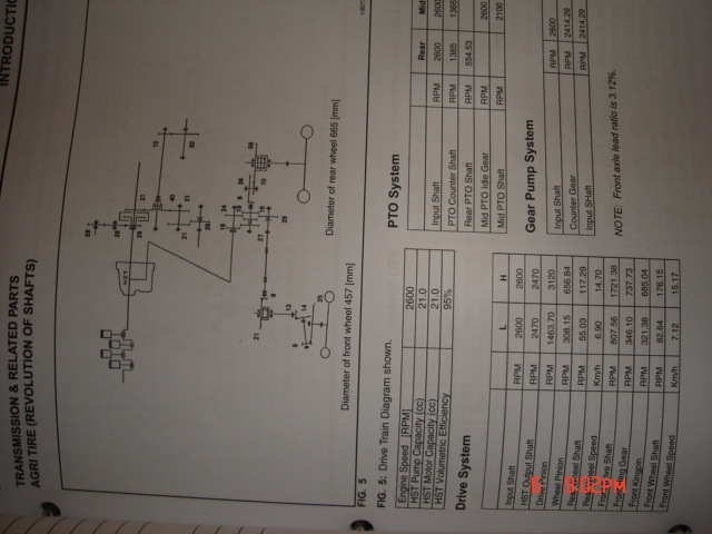

Iron Horse-- the GC2310 (and I'm assuming all of its progeny) do the same-- called front axle "lead ratio." On the 2310 it's 3.12%; you might wish to peruse "4WD engagement" thread of last June (sorry, I'm not sure how to post an internal link...:eek:)
Here's a repeat of the page in the 2310 manual that I posted last June:
