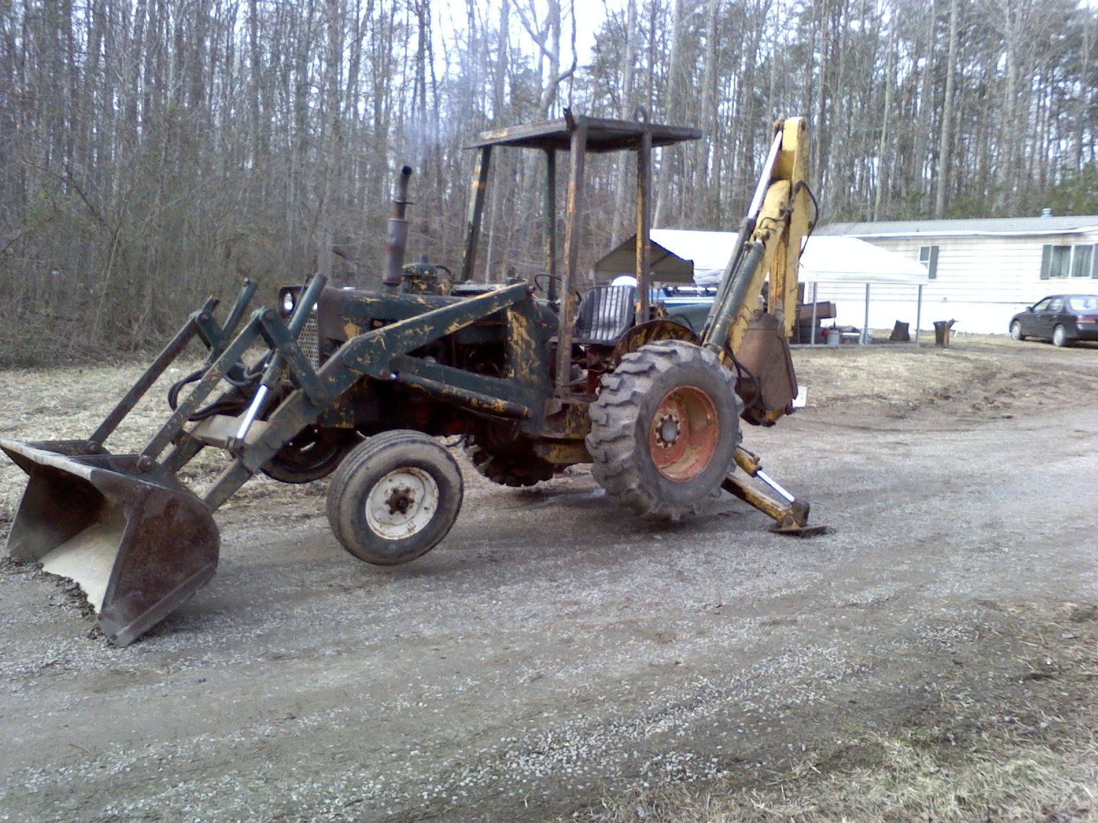

I'm looking at an old Case 580CK for a farm backhoe. Runs very smooth with little smoke. Hydraulics seem quite strong, I could lift the entire unit off the ground at idle. Quite a bit of dry rot in the hydraulic hoses and a couple are leaking. Gauges are working, but think hour meter is stuck at ~2500.
My planned uses are expanding a 1/3 acre pond to about 1 acre and other normal farm uses -- stumps and the occaisional foundation or burying utility runs.
Whats the general feeling about the old 580CK models for farm backhoes? Can get this one for a good price, but not wanting a money pit either. Could pick it up for $4000.
