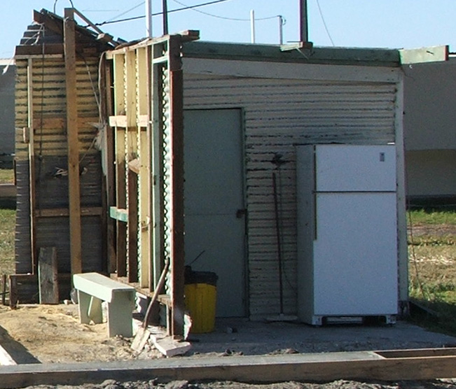

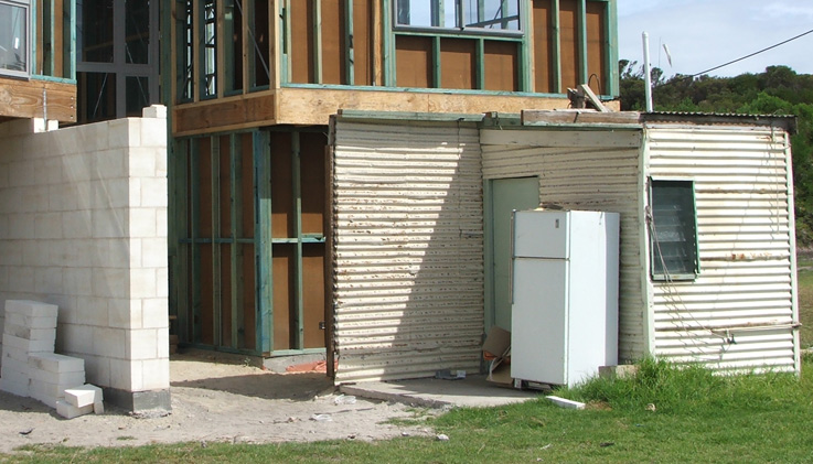

I'll get the model number when I'm down there this weekend. The best I can offer now is a couple of pics. (It sat outside for a few weeks while we were rebuilding. But it has worked since.)
It would be good cheap fix if it was just a shorted heater. I could disconnect the heater. I usually only use it for 3 or 4 days at a time so a bit of ice build up shouldn't be a worry.
