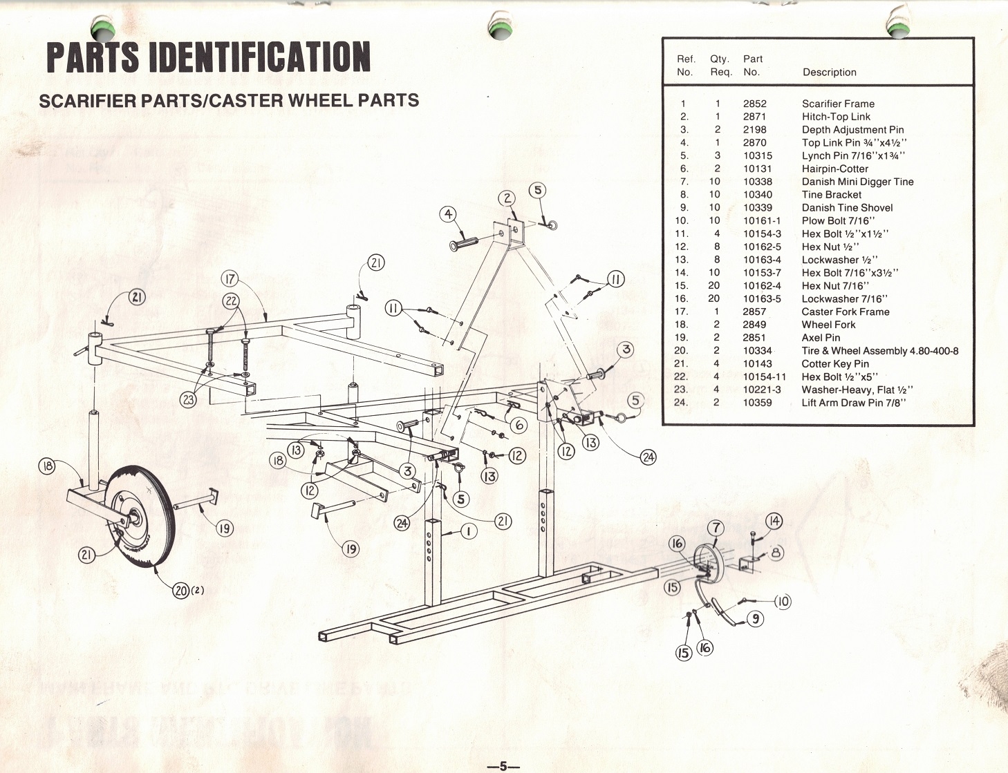

   / OLD HARLEY RAKE RESTORATION #20
Here you go...
