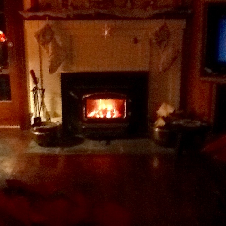

Regency small fireplace insert:
Combustion air in @ front bottom, hot air out @ top of insert. The circulating fan is at the bottom.

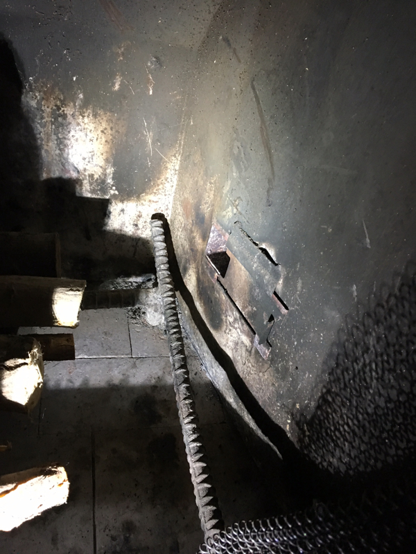

Each side of the existing firebox has a rectangular opening (picture). Inside the masonry there is a flex tube imbedded and routed into the vented crawlspace. So my thought, if enough space exists, adapt to these for combustion air rather than draw cold air across the room.

If the unit takes combustion air from the side that would work. As the video shows not all retrofit units have a separate intake for combustion air. It would be an abnormal situation, in a retrofit, to have a provision for combustion air- remember most fireplaces don't have an outside combustion air provision. So a retrofit unit that required outside combustion air from a side or rear 4" duct would be limiting. New construction style units (sometimes called zero clearance) do typically take combustion air from a 4" duct on the side or back.
To be clear. A retrofit style insert is a specific product offered by manufactures. So when you say retrofit I'm assuming that is what you are talking about.
