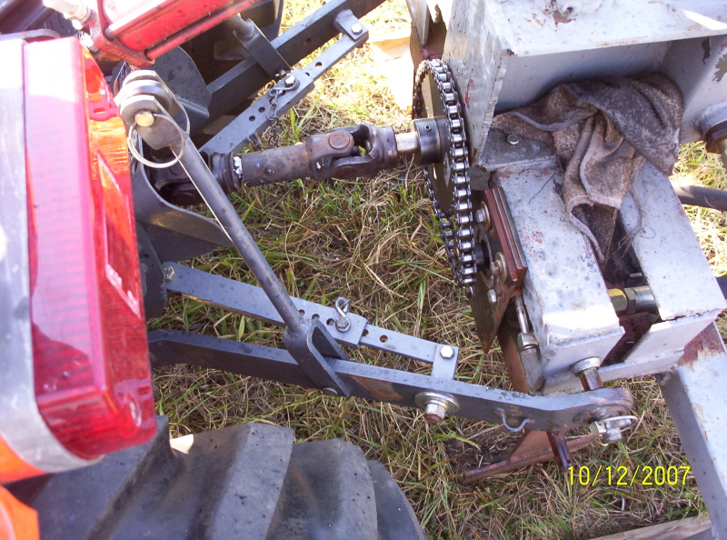

I had a feeling that pump would work just by the way you 2 were talking. Here is the way I did mine and the cycle time is good, I run my tractor from 1500 t0 1800 rpm. Just make sure you get the side load right.

Thanks Leejohn, that's an interesting design. Do you remember what size chain you used? How tight is it? This design will put some radial loading on the pump shaft even with some slack in the chain, have you used it a lot?

Stan:
Looks like you have about worked it out.
Regarding radial loads, in the gear pump the roughly half of each gear toward the outlet is under high pressure from the fluid being pumped. The other half of each gear toward the inlet side is under very low pressure; a low vacuum in most cases. If you draw a line between the centers of the two shafts, the parts of the gears on the outlet side of the line are under pressure from the fluid and the the parts on the inlet side are under very little, if any pressure. Of course, the pressure change around the gear from maximum near the outlet to zero near the inlet is on a gradient, but it is convenient to think of pressure on the outlet side and none on the inlet side.
The pressure on the outlet side tends to push the shafts apart and toward the inlet side. Therefore, the bearing load on the shafts is on the half of each bearing toward the inlet side, since the pressure is pushing the shafts back toward the inlet side.
It seems to me better to locate the pump so that the radial load of the drive chain does not add to the load on the bearing for the driving shaft nearest the sprocket. That means the drive side of the chain should be pointing away from the half of the bearing toward the inlet, perhaps even a bit angled in toward the outlet. Generally, the drive side of the chain should point toward the power sprocket in the same direction as the outflow of fluid from the pump case (assuming the ports are on the "outside" of the housing and not on the ends).
I admit that the effect of this arrangement is to add some radial load to the fluid pressure load on the other end of the driven shaft due to the moment of the chain force around the sprocket end bearing. But unless the sprocket is way out on the end of the shaft, that unfavorable force on the offside bearing should be less than the favorable force on the sprocket side bearing. Indeed, if the sprocket is placed very close to the sprocket side bearing, the unfavorable additive force on the offside bearing will be only a fraction of the reductive force on the sprocket side bearing.
At least that all made sense to me on the couple of occasions I have chain driven a gear pump that was probably not designed for a chain drive. And so far neither one failed, though I admit they don't get a lot of use. But since you cannot avoid a radial load in some direction, it makes sense to me to select the direction that logically does the most harm.
I am looking forward to pictures.

I used #50 chain and it is tighten just enough to take the slack out of it. Yes I have used it alot. That pump was put on I would guess about 5 years ago, the old pump I didn't have the radial load right and I builded it in the early 80's. That log splitter has split a lot of wood. The spec's you got should of gave you where the radial loading are. If you blow the picture up you can see the chain adjuster.

Farmerford,
Thanks for your interest, and especially for your analysis.
I fully agree regarding the forces at work on the pump interior, but I believe it may be possible to design a chain drive that eliminates external radial loading on the pump shaft. I think we can safely assume that Commercial Shearing took these interior forces into account when they designed the pump and specified the shaft bearings, but it seems unlikely they considered external radial loading on the pump shaft since pumps installed as intended would not be exposed to such loading.
If I can design a case for the chain drive that uses radial ball bearings to support both ends of the shaft attached to the small sprocket for the pump, and then add a frame bolted to the exterior rear of this case to which the pump is attached in turn, and then ensure that the two bores on each side of the case for the small sprocket shaft outer bearing races as well as the bore in the frame external to the chain drive case for the pump pilot are all concentric, would not such a design eliminate radial loading on the pump shaft? Such a design could use interior splines on the small sprocket shaft to couple to the external splines on pump shaft and transfer torque to the pump, and would feature oil seals in the bores on both sides of the sprocket case exterior to the small sprocket shaft bearings to prevent leaks. The side of the case closest to the tractor could be bolted directly to the back of the tractor using four existing large bolts, and could be bored to index to the pilot diameter of the PTO shaft boss. I think PTO shaft bearings are designed to be capable of withstanding the radial load imposed by the large sprocket and would not require outboard bearing support.
Leejohn,
Thanks for your response.
I agree #50 chain can easily deal with the torque involved, and its good to hear your second design was an unqualified success. I suspect #40 chain would also work, but it would probably wear faster. Another consideration around chain size is availability of sprockets with the correct numbers of teeth to obtain the RPM ratio I currently believe is optimum, as well as interior and exterior diameters that will work for the shaft diameters and case size. I will try to enlarge the image you provided to see the details of your chain tensioner.
I'm still not sure that it would be best to drive the pump at 1900 RPM to enable full advantage to be taken of the available 28.5 PTO HP. I don't want to labor the tractor too much, but I also want reasonable cycle times. Do you know how much flow you obtain from your pump at 1500-1800 RPM?
The cylinder I have (also from the same dump truck) has an external diameter of 4.5" and is 15" long. My woodstove takes rounds up to 19" long. I believe that this will work, but that for some hard to split chunks I may need to insert a block of wood in front of the end plate in order to allow the wedge to travel the full length of the chunk I'm trying to split. Does anyone have any thoughts about this situation?
This cylinder has either 1/2" or 3/4" female NPT connections for the hoses. It obviously worked with this pump on the dump truck, but I'm concerned about restriction. I also need to think about what valve makes the best sense, again considering minimizing restriction. Finally, I'm wondering whether it would make good sense to set relief at less than the rated pressure of 2500 psi in order to minimize wear. I really need to review all the informative design-related posts on this board.
