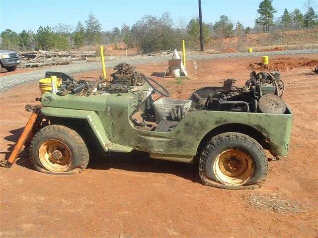

About six years ago I came across a deal on an old army jeep. Technically, it's a 1942 Ford GPW, but most of you will recognize it as a World War 2 Willys Jeep. The difference is that Willys couldn't make enough of them during the war, so Ford built some too. Ford made a few changes in there verson, but parts are interchangable, and you have to know what to look for to ever know the difference.
The guy selling it was in his 80's and said he'd had it for 18 years and it wasn't running when he bought it. He just wanted it gone from his driveway, plus all the extra parts he had, for $100.
I had it in my driveway for over a year, then I hauled it to Texas, where it's sat for almost five years. During that time, I revised what I wanted to do with it. I'm married now, with two kids and it would be really nice to have a fun vehicle for all of us to go for rides all together.
I looked at golf carts and UTV's but kept thinking about my old jeep. If I got it running, it would be much better then a golf cart or UTV for what we want to do. Plus, I can get it running for allot less money.

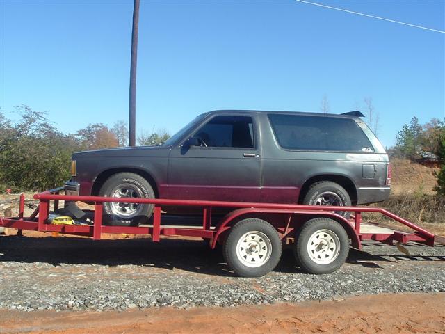

Last year I found a 1988 Chevy S-10 blazer for sale on ebay that was less then an hour away from me in Athens TX for $300. I wasn't sure if it would run for that much money, even though he said it ran good. I fired right up when we got there, and I was able to drive it right onto my trailer. The kids and I drove it around the place until we ran out of gas, then I parked it next to the jeep. They have been sitting side by side ever since.
The front end was lowered and pretty much ruined, but the engine runs great!!! It's the 2.8 V6 with five speed manuel transmission and is 2wd. I don't have any need for 4wd as this is just for driving around our land on nice days. No mudding, or off roading. :D

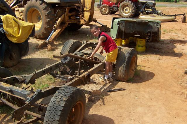

They had a great time and will work on taking something off of it when I'm working in the shop. Peyton is 6 years old and he got a set of "real" tools for Christmas. He takes his ajustable wrench, pliers and screwdriver to it and can spend hours taking things apart!! Sometimes Alissa (9 years old) will join in and they will work together on it.

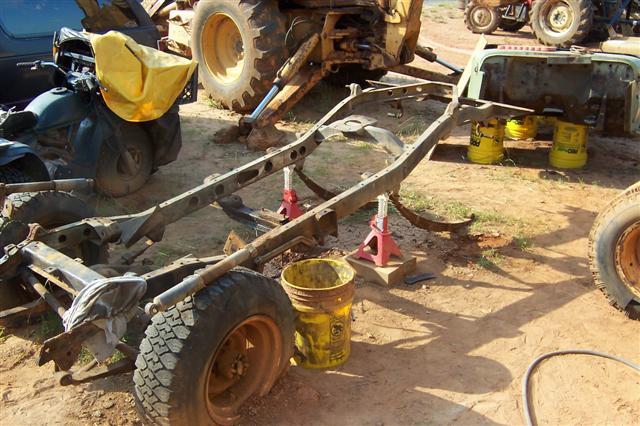

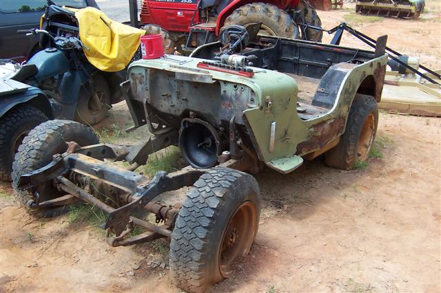

Today the three of us spent the entire day stripping it down.

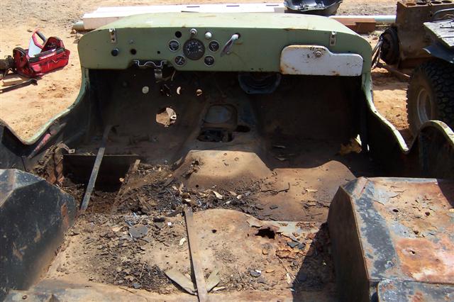

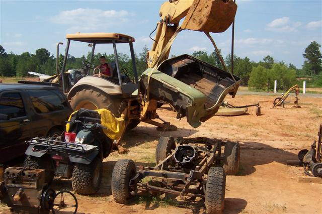

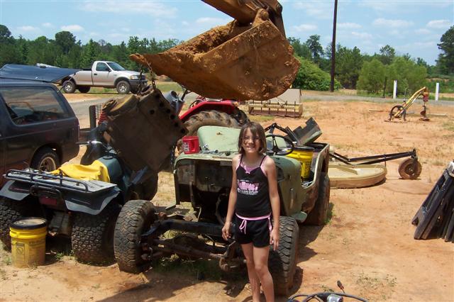

So just bolt the engine/trans/miss out the blazer into the jeep, blast/paint the jeep body and run it. Ya may want to put the blazer steering in the jeep along with the rear axle too. Of course wacking the top off the blazer would be easier.

Eddie, if that GPW was/is in original condition, you might want to find a different jeep such as an old CJ to transplant the Blazer's drive line into.
There is a military jeep website that can give you much better advice than I can as to whether that is a very valuable old jeep or not.

Great project. And the kiddo's look like they are having a blast. I know you know better, and it is probably the camera angle, but the pic of your daughter looks like she's standing right under the backhoe bucket.

You pretty much summed up my plan. I want an engine that I can get parts for without any problems, or delays. I want it to be reliable and fun to drive, but also easy to drive so Steph or anybody else can drive it. Heck, the kids will probably learn to drive on it in a few years.
The engine, transmission and rear axle are the main parts that are going into it. I think that will be fairly simple and easy to do. The power steering will be a little tricky, but I don't see any major issues. I want the power steering, so it's just a matter of making it happen.
I also want power brakes and front disks. This is where it's gonna get tricky, because I also want to use the original front axle. When it's all done, I want it to look like the original WWII jeep. The front differential is very important to me in that look. So I have to figure out how to get the disks and calipers from the Blazer to fit onto the jeep axle. Don't ask me how, because as of right now, I don't have a clue. hahaha
I did consider just swaping bodies, but it's realy not what I want to do. The blazer is allot longer and wider. The frame wold take allot of choping and I only have a very small amount of experience in that. Not something that I think I can do and know it's perfect. 90 percent might be OK, but I'm not gonna try it. I like the body to fit onto the frame and feel I can come up with mounts to install the driveline easier and better by using the original frame. We'll see.

Your correct, the camera makes it look like she's standing under the bucket. She was probably four or five feet in front of it, and was walking by when I told her to stop to take the picture. They know to never walk under any part of the tractors.

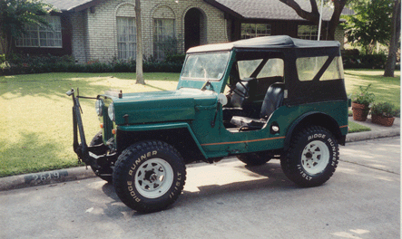

I had a CJ-3B that was in the family since the 70's, 1956 if I recall. It ran great (F-head), I rebuilt the engine, new leafs, new style axles (no more balls and knuckles), brakes, steering, converted to 12v, a rare thing was it had a full top with doors that would keep you dry, it was even street legal until Texas said you had to have liability insurance which I didn't want to pay for. It had some rust and bondo but in the end it was just to big to use at the time. I sold it for $1700 and moved into a 4-wheeler (also sold my 3-wheeler). Even after building the weekend house I've never looked back at the jeep. I can go more places with the ATV in the woods and such. I got a lot of the parts from JC Whitney. At the time you could get just about everything.
