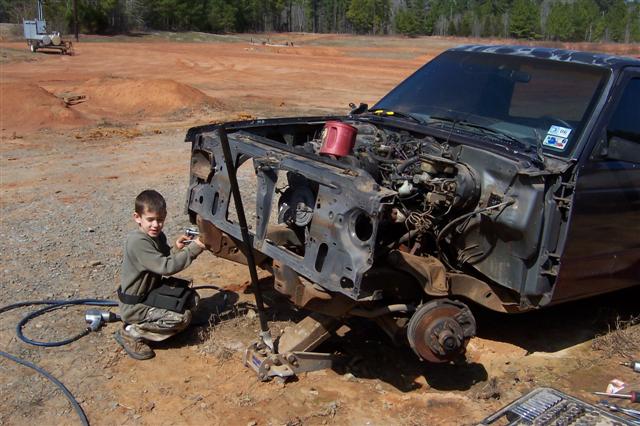

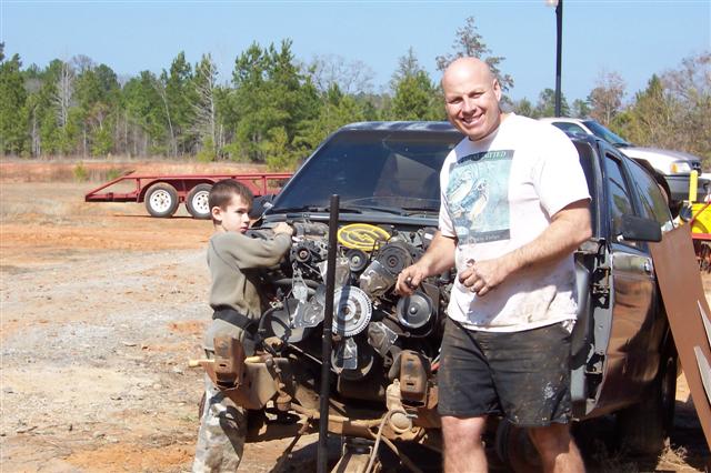

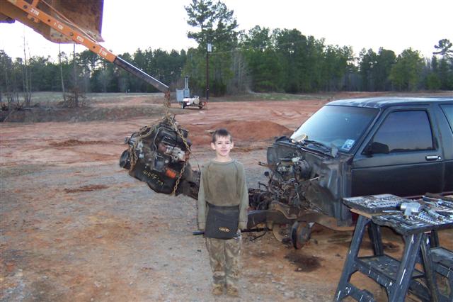

Peyton woke up early this morning and ready to go!!! He was excited because he had another set of camoflage to wear, JUST LIKE YESTERDAY :D
Steph and I weren't amused being woken up so early, but had to laugh at his energy and enthusiasm. I got up, but made him wait for me to finish my cup of coffee and surf TBN for a bit.
Then we got into the blazer. Off with the fenders, grill and hood, then off with everything that was in the way of getting the engine out. He was taking things off faster then I could keep up. He just loves that impact wrench!!
I really didn't think we'd get it out, but knew that if we didn't, I'd have to remove the cherry picker from my FEL bucket and put it back on again. Lazyness is the driving force for allot of things that I do. I'm too lazy to do it twice, so I just get it over with.
We have piles of stuff all over now and it's gonna be trails through the shop for awhile. At least we have some stuff to work on in the evenings and on rainy days.

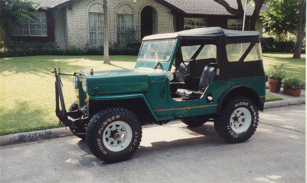

Found an old picture of mine. It's a 1956 CJ3B with the F head engine. My uncle bought it ro run around the farm in Mississippi about 1975. Previous to that another farmer had it. My dad bought it about 1980 and used it at the beachhouse. I got it around 1988. Until I sold it it stayed in my neighbor ladys garage across the street. She is a widower and liked having 2 cars in the garage, epsecially a manly jeep! :D When I looked into restoring I found this model was not as desirable as many. Because of the F-head engine (intake valves in the head, exhaust in the block...made the engine taller), it was deemed and high hood, flat fender model. I think this model was sold as a civilian model to.
I sold it around 1999 for $1800 to help buy a 4-wheeler. It was street legal and towed easy. My dad and I ringed it in the early 80's and that was it. It always ran sort of crappy (it loaded up badly) until I spent about $150 and a NEW (not rebuilt) carb. Ran like a top with the new carb. I changed out the front axles from the ball bearing to a u-joint. Prior to that this was our only problem besides the hard starting, turn to sharp and the worn ball bearings would fall out of the knuckle...it would not roll after that. The hard starting was cured when I converted it to 12v. I left the 6v starter in there. Even after sitting for a month or 2 with the new 12v system it would crank in about 2 seconds with the choke. With the top and doors it made the old jeep very desirable. Tops alone are real pricey.
I put some money into this jeep but I got it for free. I got many parts from JC Whitney. These days you have to be careful on a restore or fix it upper. You can get a 70's or 80's jeep pretty cheap. I found a mid 80's in Elkhart for $4000. Look good and ran good.

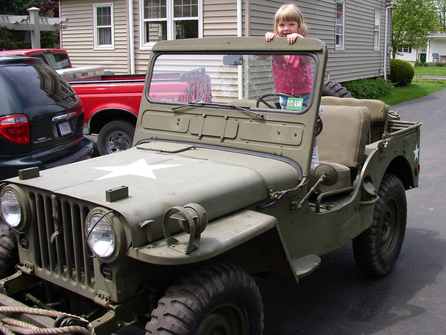

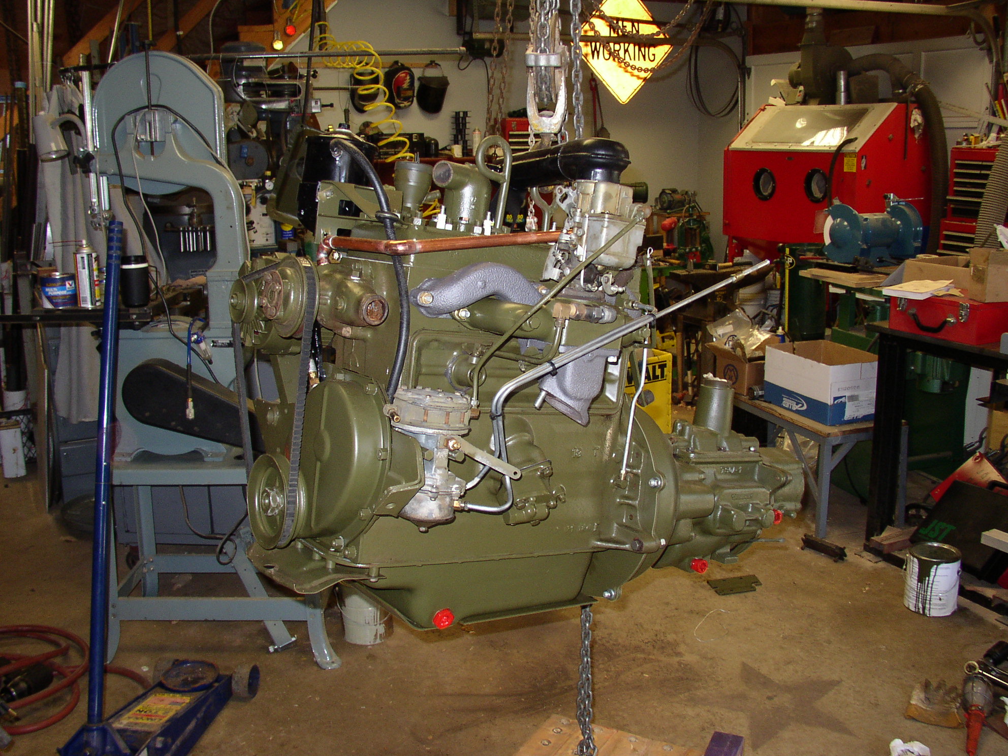

This is late in the post but I wanted to share my jeep experience.
I bought a basket case jeep in similar condition to what you started with when my daughter was just born, the deal was I would sell my motorcycles when she was born so I put the money into this jeep.
A few years later, you can see my daughter in the drivable jeep. This one is a 1952 M38 Willys Jeep. The pics show the engine/tranny/trans in all their rebuilt glory. I rebuilt the axels, engine, tranny, transfercase, steering box, full brake system, distributer, oilpump, carb, fuel lines etc all myself. These are really easy to work on and reliable if you know how to work on 40's technology. I have never broken down etc and put about 1000 miles a year on it. My kids drive this in low/low around the woods but I will probably never let them drive it on road, they really do filp too easily. Every part is availiable overnight, every day the parts are easier to come by because most are back in production on or offshore. I have about $2K into it for parts for all the rebulding etc... I am sure I could get 6-8K in today's market for it.
My daughter was small but she could start the bolts and hold / turn things for me so it was a good experience spending time with her. Now I am 'refreshing' a 1985 6.2L detroit diesel engine so she is helping a bit on that as well. She can't seem to torque the headbolts buts that's ok.
So.. have fun. Consider putting all the old parts on Ebay, most will sell to guys looking for missing original parts.
The combination of large tires, narrow wheelbase,hieght and light wieght make them fantastic offroad in stock condition. Add more weight and they become dogs. It is fun to park next to a CJ7/YJ Wrangler / Current Jeeps to see how much they have changed from utility trucks to chick cars.
Military truck manuals are in the public domaign and do not carry a copywrite. These can be downloaded for free on sites like, Steel Soldiers :: Military Vehicles Supersite. My jeep had 3 manuals that covered how to rebuild every single part in it.
