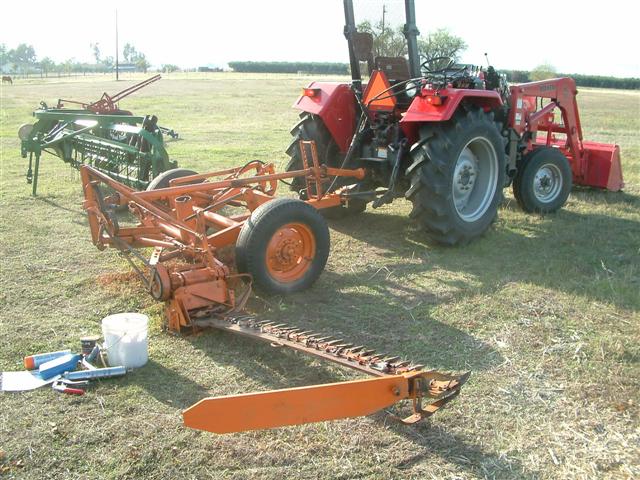

How to you plan to rig up the engine/speed reducer on your pull behind sicklebar? For reference here's my Allis Chalmers 80T seven-foot sicklebar. It doesn't seem like a big job to retrofit this type of mower for ATV use.
Good luck
/ Old sickle mower #7
If someone is UNFAMILIAR w/ riveted blade attachment, broken guide forks, and bent and deformed cutting bars, they are in for a rude awakening.
