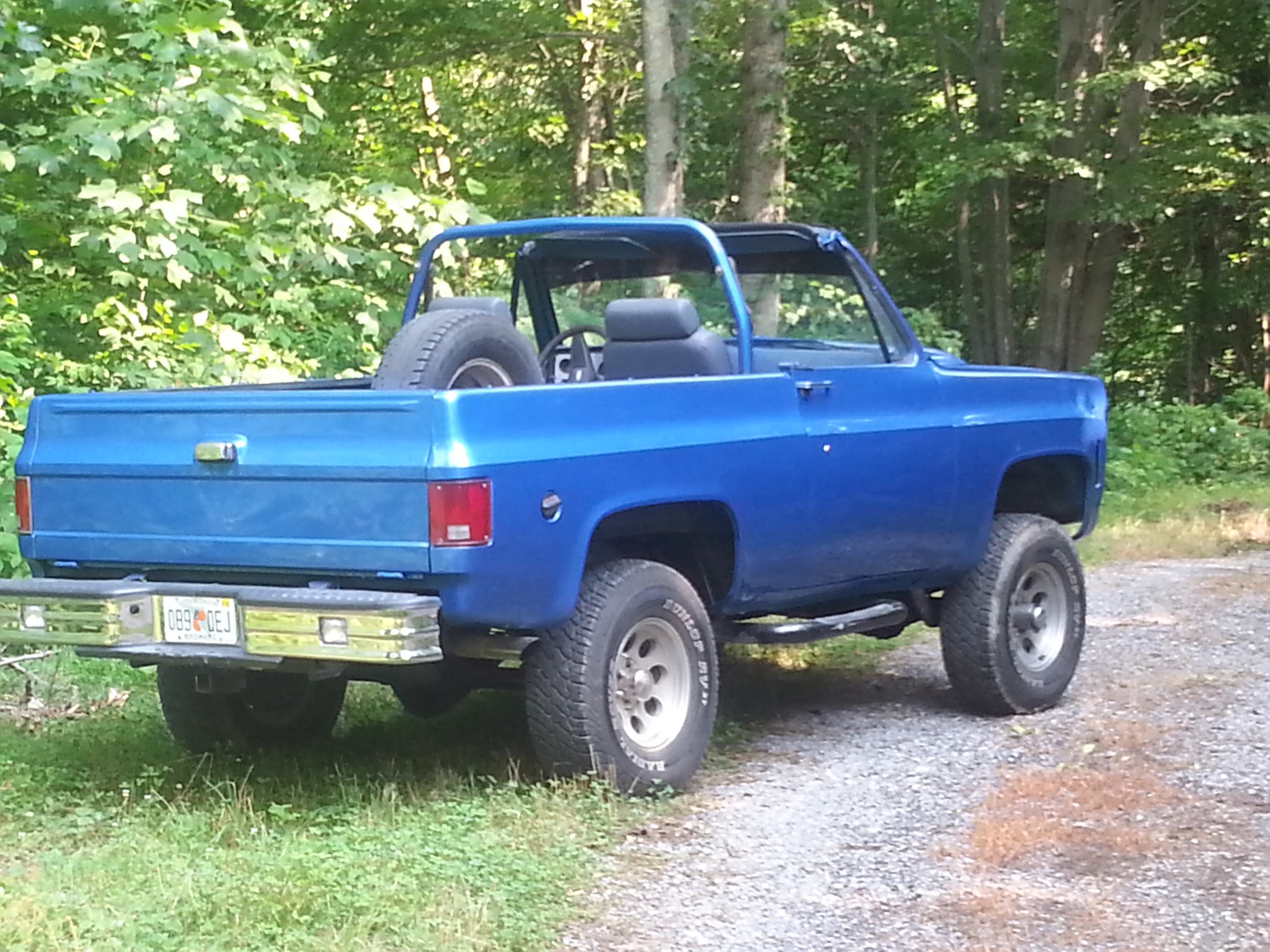

Window regulators have a life span and these may have exceeded it! Pivot points wear, the teeth on the sector get worn, rollers get loose, etc. At some point no amount of cleaning and greasing will make them work like new. At the very least, remove the regulators and clean the old, fossilized, dried up grease/dust crud out of everything and re-grease with white grease. Make sure everything is adjusted right, also.
Pop the door panel off and see what you have and go from there.
Guys, I thank you. I don't think those regulators are real expensive so I think I'll order new ones. The tracks have felt but it is half gone and petrified, ought to replace those too. And the adjustment.....don't know?? The rear post/frame of the door is cut off to make this model a "convertible" so there is no rear window track. It wasn't this bad 20 years ago......duh. Thanks, again

.........................The rear post/frame of the door is cut off to make this model a "convertible"...................................
Unless someone put the wrong doors on it, you don't have a '75. Until (and including) 1975 models, the entire top came off from the windshield back and the doors had frameless windows.
You're right, the orig doors were so badly rusted out midway and bottom that I ordered "replacement" doors from LMC. The aftermarket doors that I received were full frame pickup type doors. When I called them they said that the orig doors were "not available" After 42 years guess it's hard to stock parts. The truck IS a '75 as it had the full fiberglass top and roll bar on it, the VIN/equipment label state '75 also. :thumbsup:.
