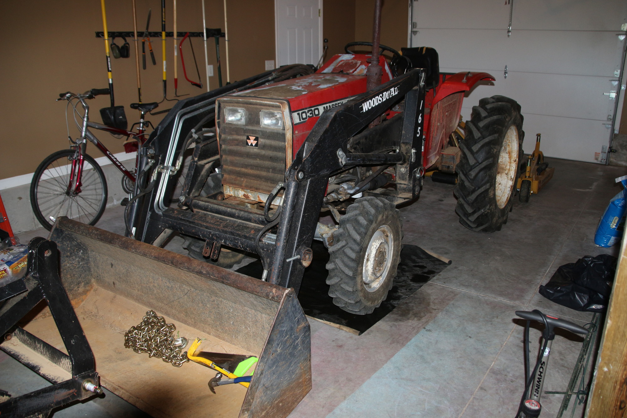

Pictures will of course be forthcoming. We got about an inch of rain yesterday afternoon and overnight so all I got to do so far is unload the tractor from the trailer, drop the box blade off in the garage, use the loader to pick the finish mower out of the back of my pickup, hook it to the 3-point, and then park it in the garage. The lighting in my garage isn't great so I'll wait until I can take the tractor outside before I get pictures. I also will be changing all of the fluids and lubricating everything as well, which fortunately I can do in my garage when it's soggy out.

I've had my tractor for a few weeks and attacked some of the things I mentioned I wanted to do earlier. Here's how it went:
1. I used the loader and a log chain to remove some 6x6 wooden fenceposts and 2x6 fence rails with the loader as the original owner had a calf chute set up between the two pens, and only a 5' wide entry gate in the smaller pen. I had to nudge/rock a few of them as some were buried 4' deep in the ground and I couldn't just pull them straight up on the first yank like one of my Dad's tractors would have been able to. In the end the tractor did a good job on this and I am very glad I had the loader.
2. I rough cut the two donkey pens with my Dad's 5' Bush Hog. He put both the tiller and mower on the trailer and thus I had to use the loader and a log chain to remove those as well. There were 6 about two foot diameter half-rotted stumps and some old split firewood hidden amongst the chest-high ragweed and devil's walking stick. I steered around the stumps and the tractor had no trouble mowing at a normal speed. Apart from the stumps the area isn't as rough and ugly as I had thought now that I can actually see the ground and not mountains of ragweed. The 1030L is sure more maneuverable than any of my Dad's tractors, I'll tell you that much.
3. I used the 7' King Kutter tiller to till up about a 30x50 area in the smaller pen for a garden. The 1030L handled it fine in its lowest gear (0.4 MPH if I remember correctly) and operating at full width and depth. Going much faster caused the engine to bog a little. My verdict on the tiller is that my tractor can handle it but a 6' one would be a much better fit if somebody has a similarly-powered tractor (23 PTO HP) and is looking at buying themselves a tiller.
4. I got a 72" rear discharge finish mower for cutting the lawn. It does a pretty good job and it's a good fit for the tractor. It excels in cutting the thousand or so feet of road frontage as it's a nice long straight shot. It's a little less handy near the buildings but not too awful. I think I should be able to use it in the ex-horsey area too.

I posted them in the Massey section initially but I'll post them here as well:

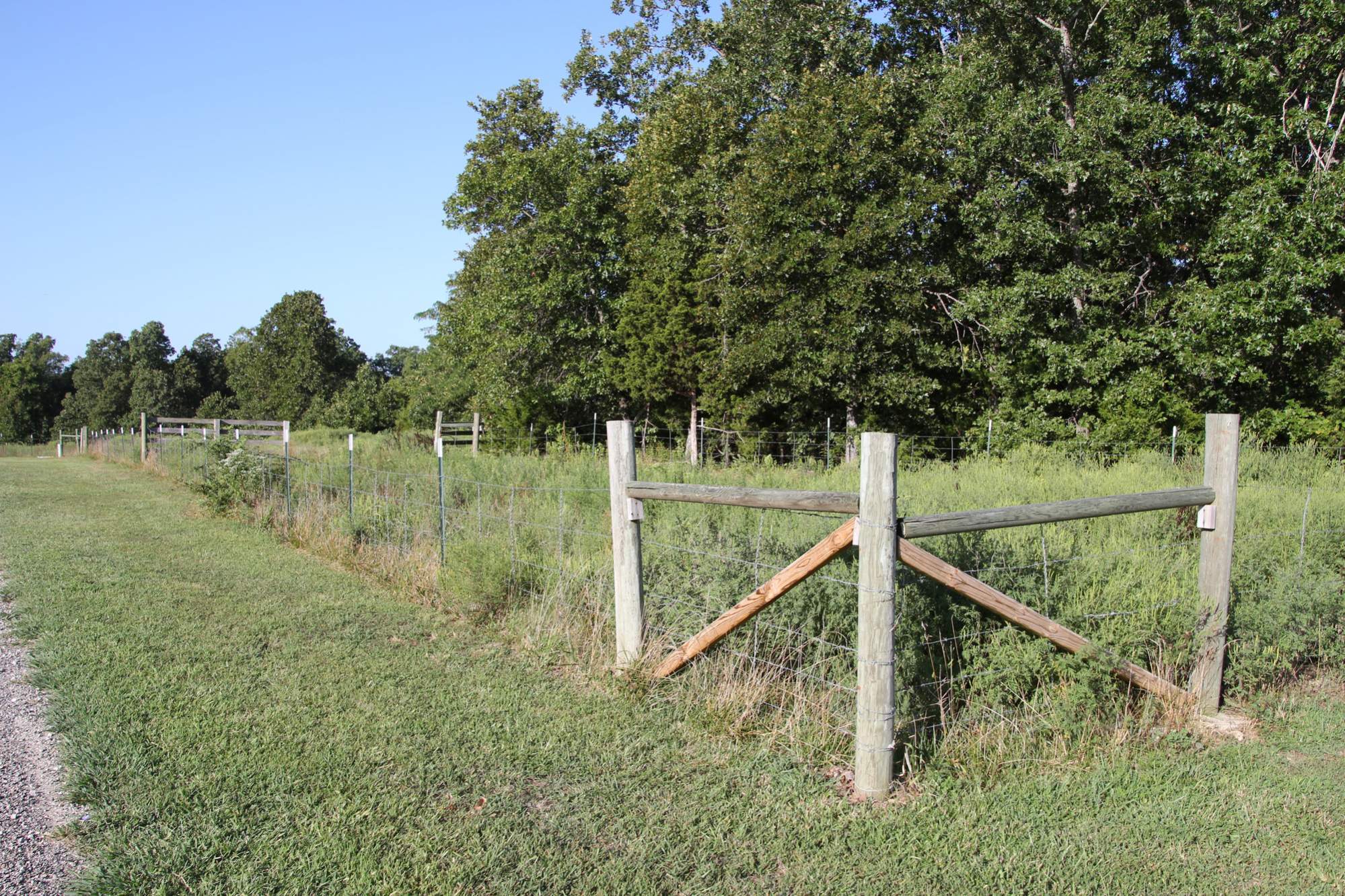

Part of the horsey area before it got mowed and tilled. It looks a LOT different now.
